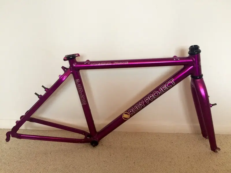

I bought the frame a while back off ishaw from this forum. Thought I'd start a thread running over here for this bike since I've got one over on LFGSS. Apart from a SS clunker I built to do the Isle of Wight challenge, this is my first mountain bike - so it's been a bit of a learning curve what fits, what the size standards are etc.
Short of the story is I used to commute by bike. I injured my knee badly, had a botched knee op and now can't really ride any distance at all despite still loving my bikes. I got a new job and there are some trails and a lake nearby that look like nice gentle lunchtime rides to me, so I needed to build an offroad bike with fairly relaxed gearing. Enter the Rudy Project frame locally, round at Chateau ishaw...

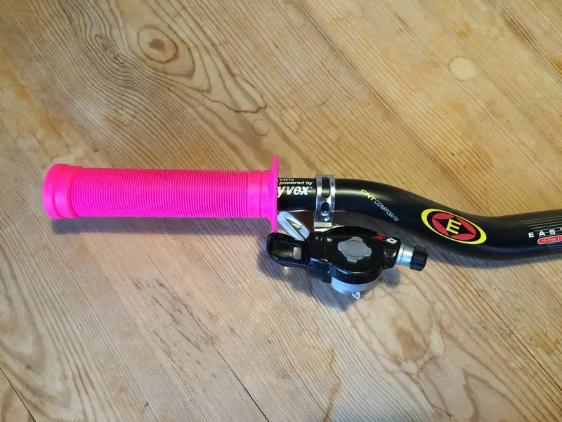

If you're familiar with HHSBs, I quite like a bit of slavery, so wide risers are on the cards. I've gone for carbon Monkeylites and pink mushroom grips.

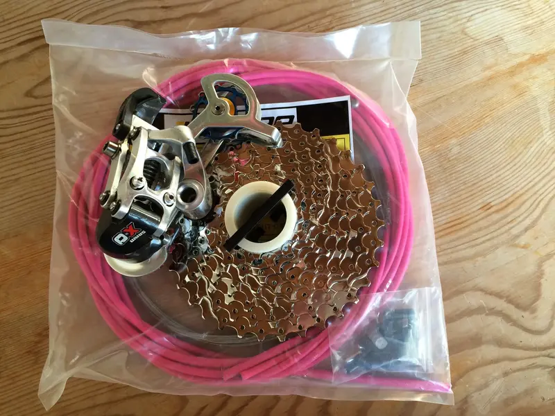

Gearing took a bit of sussing out, what with all the different brake and shifter mounts. I've decided on a 1x9 setup with SRAM XO.
Cranks are Race Face Deus. I got some bashed up ones, shot blasted them and repainted in satin black.

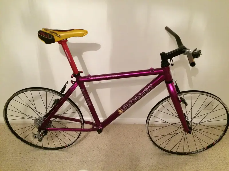

Black wheels, will be a black carbon post when it arrives and this is where it's currently at:
In the post are some tanwall tyres. Just need some little bits and to sort out some brakes and I should be good to screw this together properly fairly soon.
Interesting frame. Built by Verlicchi in Italy. Possibly the fork is the same as used in the nice S-Bike models. I have a Rudy Project Downhill.
Yeah, there's not a lot of info out there about the frames apart from who made them. It's definitely really nicely made and finished well. Would be quite cool to find out what year it was made.
Dare":1u7vdajk said:
Looks very interesting! No black saddle?
I think it's going to look ok with the black seatpost!
Getting there. Chinese seatpost arrived but they've sent me an aero post instead of a round one.
Tyres are exactly how I wanted.
