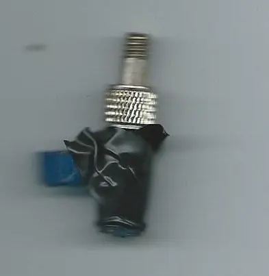

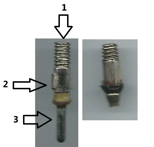

the forks are rodem hydro 1 and had no air in them. after a quick look up on google it seemed like it was going to be a tough job. I found no answers on how to improvise a plug, so I decided to share my (very non hi-tech) solution.
after some fiddling around I found some plugs to inflate an old airbed.
one end has screw thread and the other end is cone-shaped.
a standard tube valve almost directly fits on the screw end (see pics for details).
the side that you put in the valve is cone-shaped. I have sawn it of so it would almost fit the screw-thread of the fork. then I heated the tip of the plug and twisted it in the screw-thread. finally I put some isolation tape on to make the plug fit airtight.
I hope this thread will, one day, be useful to someone; writing this down took me more time then getting the forks working
