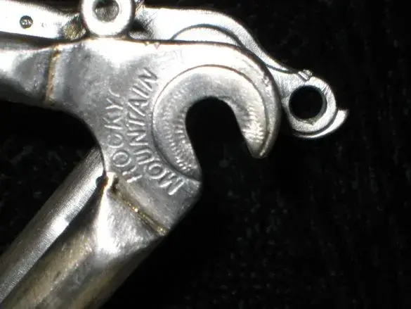

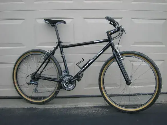

For what it's worth I have a '92 Equipe with a very close serial number "I9108041"
No Ritchie dropouts but I've attached some pics for you to compare.

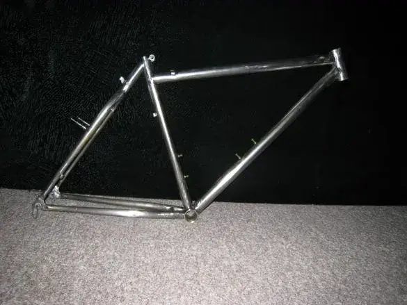

Well I've no idea what it is :? Whatever it is, its pretty light :) on my new fancy pants digital scales it weighs 4.43 lbs :)
edited because I was being a thicko over the top tube length :lol:
I love these "ID me" posts. I've studied the eBay pics of the frame in question and I would now be putting money on it being a 91 Hammer.
The pics in the ebay post show what looks like a collar line on the seat tube below the top tube (similar to the blizzards of those days without the huge seat tube extention) Secondly are the Ritchey dropouts and lastly is the placement of the cable guides.
If you look at the 91 catalogue, the cable guides are in the correct place for the bike we are trying to ID (this is the only steel frame with the wishbone seat stays and the cable guides on the head tube other than an Altitude but it has a different seatpost binder) Secondly the 91 shows the bike was built using Ritchey Logic tubing which would account for the dropouts. Lastly it appears to have the same seat tube "collar" in the same place.
I had a run through the steel bikes with the wishbone stays and the 91 Hammer fits the bill to a tee in my opinion. I happen to own a 90 Hammer and I can say it is one fun bike to ride. It is very fast, and a dream to control, not cramped not stretched out.
