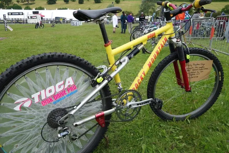

I found a damaged Rocky Mountain Edge on ebay and with 30 minutes to go and no bids, I made an offer. So it's underway now and should be here next friday. Of course I glossed over the size and it's too small for me (should have been an 18"). But anyways, I always liked these and as the predecessor of my 1999 Element (Dutch), I think I'm building it as a shelf queen for now. Also, the headtube is cracked, so riding without doing something there is out of the question.
I think it's a 1995 model, since it comes with the air shock and alu rear end. The 1994 version had a spring damper and a steel rear. In 1996 the first Element was introduced, replacing the Edge. But I cannot find this yellow color in any catalog. Was it a limited color, or was it resprayed (Maybe for a particular team)?

The colour is Yo Yellow, the same as they used on their other Team Only frames.
I remember seeing a yellow one at a shop in 1995 built with a red Judy DH and neon yellow Maguras. Very cool looking bike!
