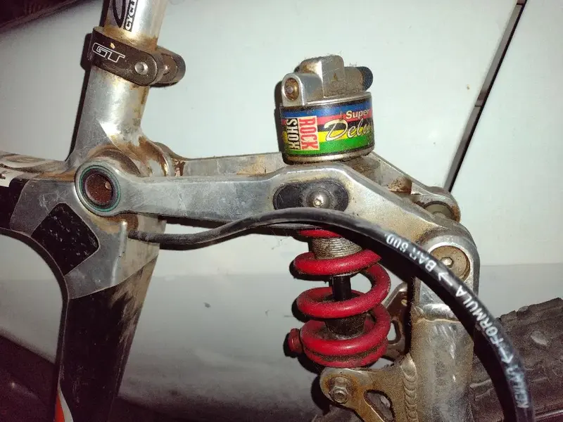

Hi. New here and I just picked up a GT STS DH.
If it will fit this bike I am interested. PM me with price/shipping details if this is a direct swap.
Here is my old shock.
It should fit, I haven't got a bike to test for with anymore, but I bought it as a spare for my sts. The trunnion on this shock is different to the sts/lts version, but if you have the lts trunnion, it will screw onto the threaded part of the shock as a direct replacement.
If you have a shock on your frame, send me the measurements and I'll confirm if they are the same.

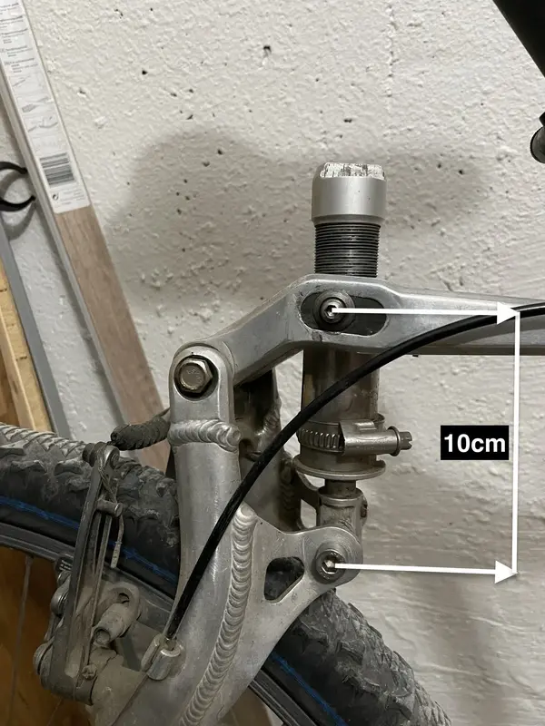

Hi ishaw, measurements of the rear shock are as follows:
from centre of the trunnion to the centre of the lower bolt - 100mm (this is fully down position) as I don't have the spring, and fully up position is 125mm so I think it will fit.
Please see pics for details.I have the lts trunnion nut as well. Please send me the details for the shipping and how much it will cost everything. Thanks in advance.

Sorry for the delayed response, I'm not getting notifications when people reply on this thread.
I've measured the shock. It is around 180mm from the centre of the lower BTS to the very top of the shock. 155mm from the centre of the lower bolts to the top of the threaded section.
The spring in 90mm.
Hope this helps you work out if it will fit your frame. If you need any other measurements, let me know.
