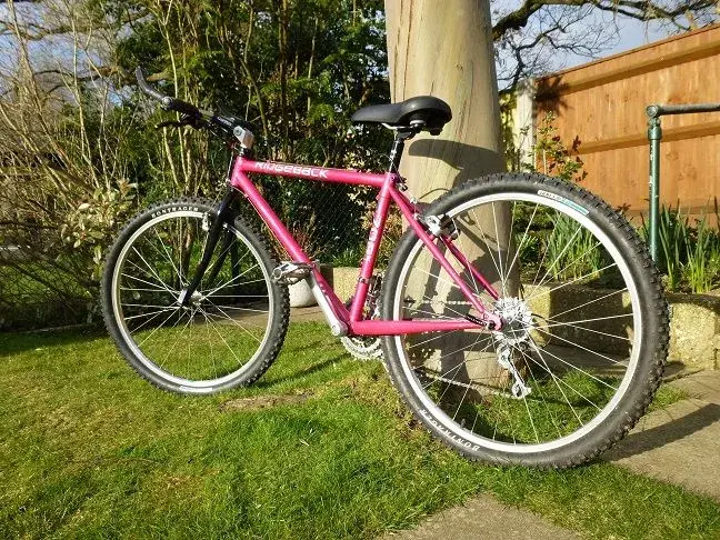

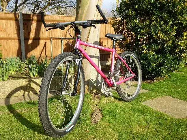

Yep the Dx really doesn't have a big case & everythings squeezed in quite tight I've cleaned it with degreaser, a toothbrush regreased & worked the mech again & again & again & it's not having a bit of it, I suspect it's furred up. Got some tatty xt shifters coming which will have to do the job for now :? .
Getting a bit impatient so decided I'd have a go at repairing the shifter, erm, yeah. Actually wasn't that bad. I've stripped it de-greased it looked for corrosion or any other visual hints to the fault & found nothing, re-assembled & re-greased it & it's just the same :(
So I actually managed to fix the shifter! So after a few adjustments & general check over at my Lbs (It is going to have my nearest & dearest riding it) It's finally finished :D
A fair few parts have just been dug out of the garage so apart from the new cassette it's been a fairly cheap build.

Weight: Heavy, about 13.4kg :lol:
