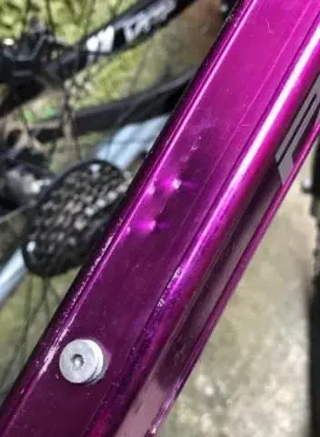

Pic 1 - Damage to downtube

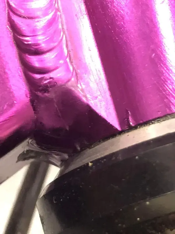

Pic 2 - Crack to Headtube Weld

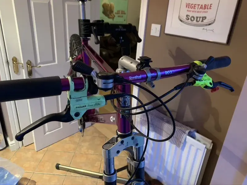

Pic 3 - Miss-matched brake levers

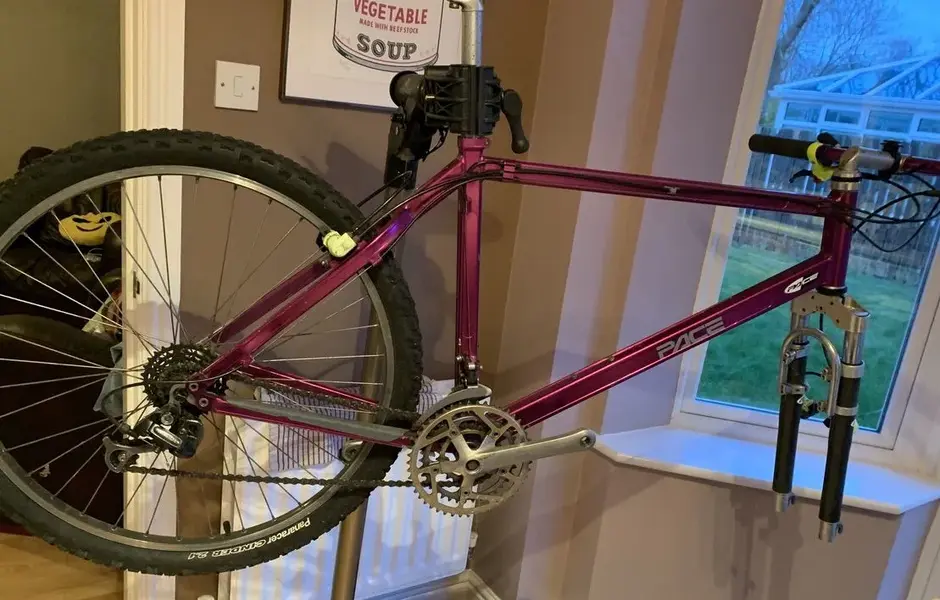

Pic 4- In my kitchen strip down commenced

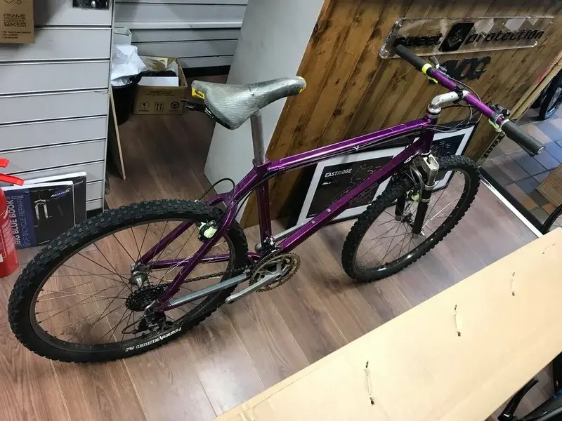

Pic 5 - Ready for collection
Pic 6 - Parked up looking good

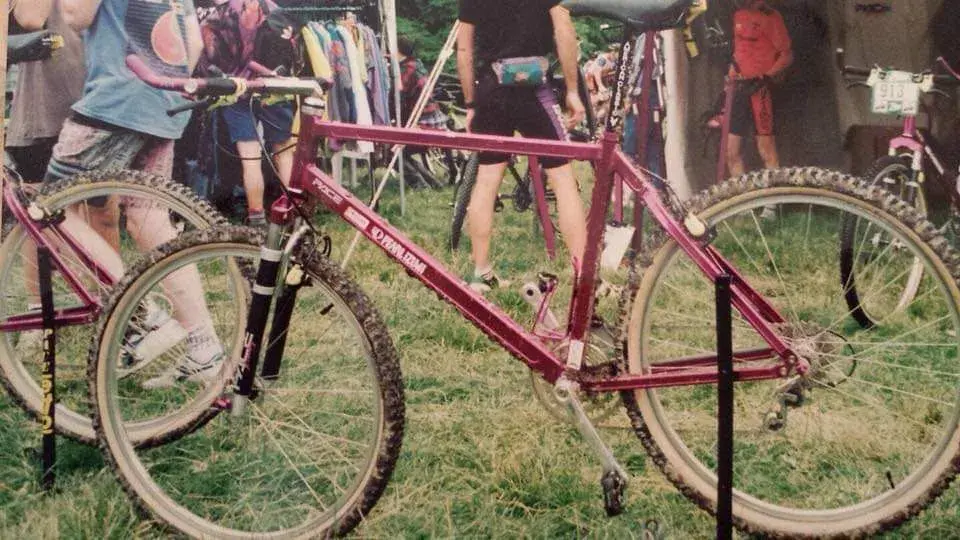

Pic 7 - The Bike in its heyday being ridden by Rich

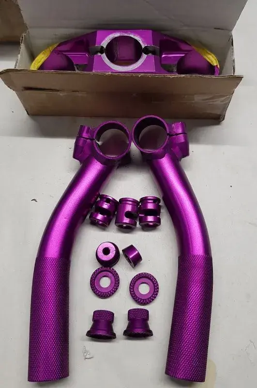

I’ve tried but have been unsuccessful in relation to uploading a video of a fantastic gift I received. A parcel was sent to me all the way from Canada with an awesome selection of goodies. The standout item is the original Royce BB from the Pace when Richard Thackray raced it
My aim from the outset has been to retain as much originality as I possibly can and having the bottom bracket to return to the F1 is a big step in that direction
I am truly blown away with the generosity and support I’ve been given so far and hopefully there will be more exciting updates
If anyone is a member of the Pace owner’s group on FB the video is on the thread there. In terms of the BB it’s started its journey to Royce via Canada and the North East for the engineers there to give it a factory service. I will post a picture of it when it has been returned

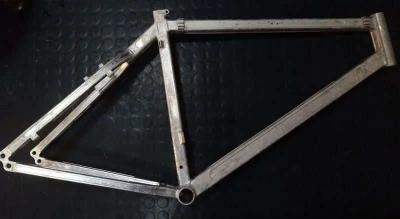

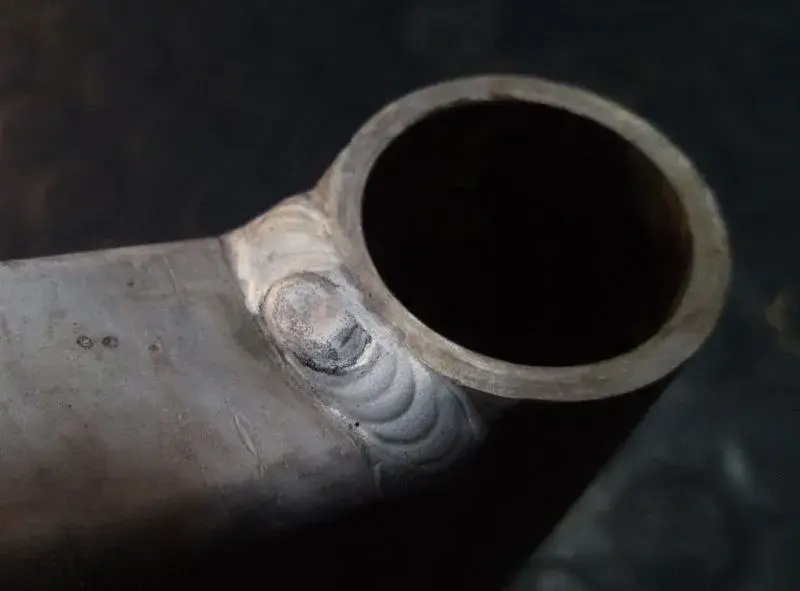

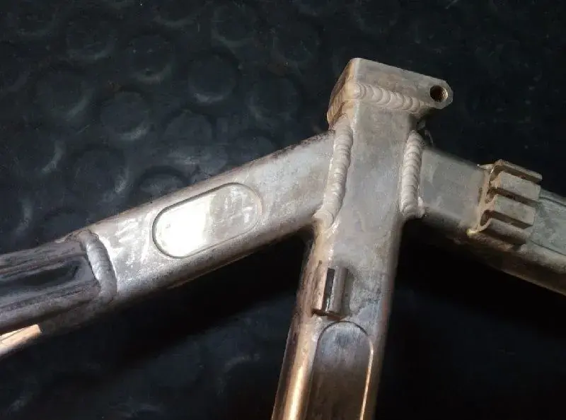

Right then...previously on The Purple Pace build thread we had got as far as cutting out the crack in the headtube/down tube joint... :)
Now making things better:
First tight pass to fill the crotch of the cut out joint. A bit of slag inclusion from the inside of the weld, but not major:
Then finish with a clean second pass (photo after caustic etch):

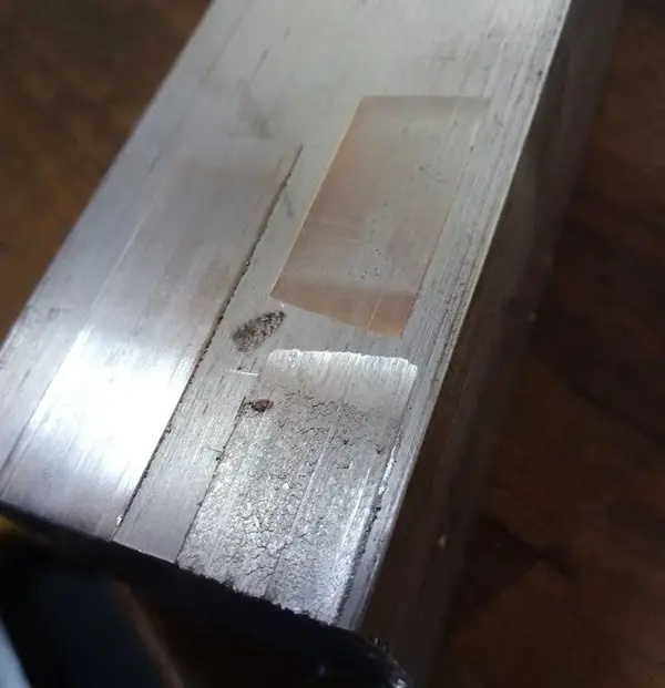

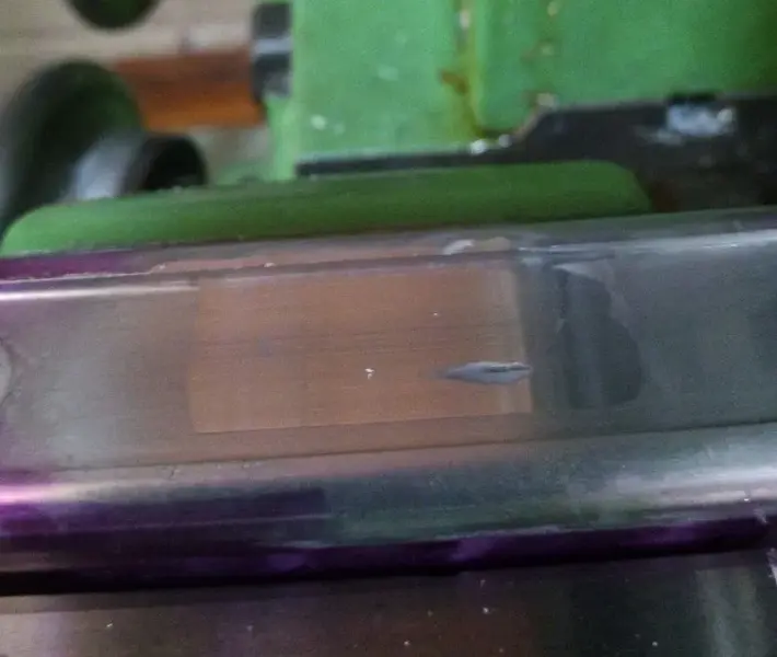

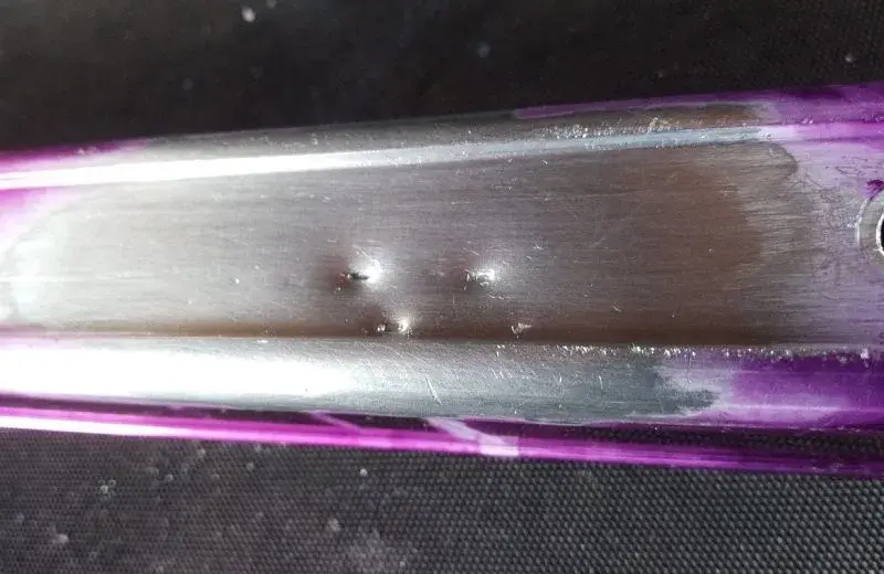

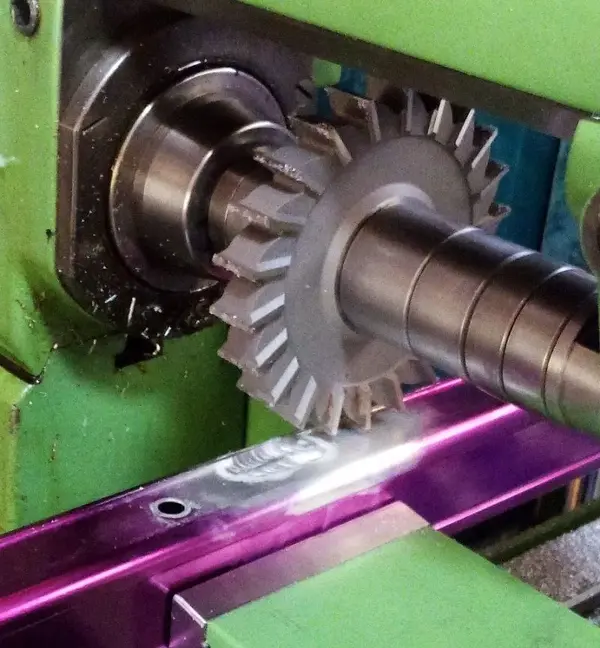

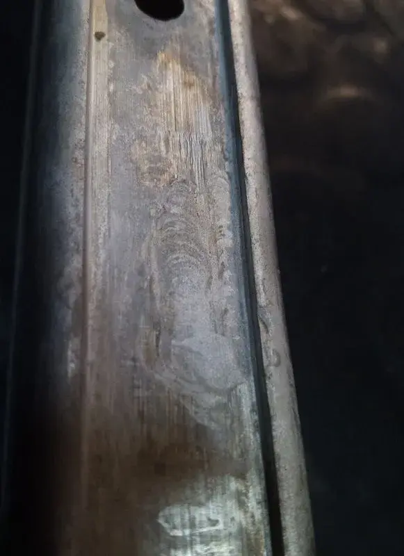

On to the three small pierced holes on the downtube.
Short weld to fill, then to horizontal milling machine to remove back to the original tube surface.
I wasn't happy with the smeared finish from the cutter on a test piece, (bottom right) so had it re-sharpened and tried again (Left and top right).
Happy with that, but for the small low patch left from the weld pool, but best not weld a 2nd time in the area, so will leave that.

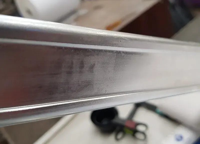

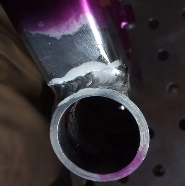

Finish off the caustic anodising strip all over. This cleans off the anodising, first the colour disappears (which is just a dye), followed by the anodising itself.
At this stage all the non-aluminium alloying elements are deposited on the surface, and the result is black, grubby and patchy.
Not to worry...a quick bath in a dilute nitric acid solution lifts this and cleans up much of the surface.

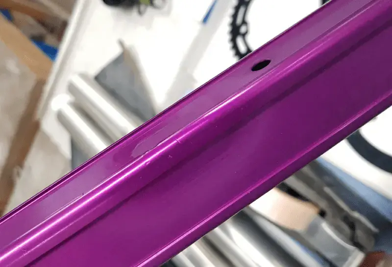

This is the area that was welded and milled back. As you can see, the weld pool is showing in the material although the surface is flat:

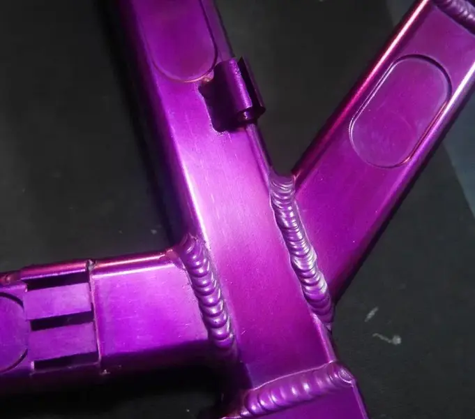

Re: Richard Thackray Team Pace - Restoration Thread

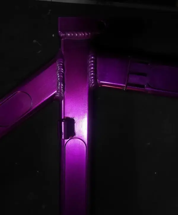

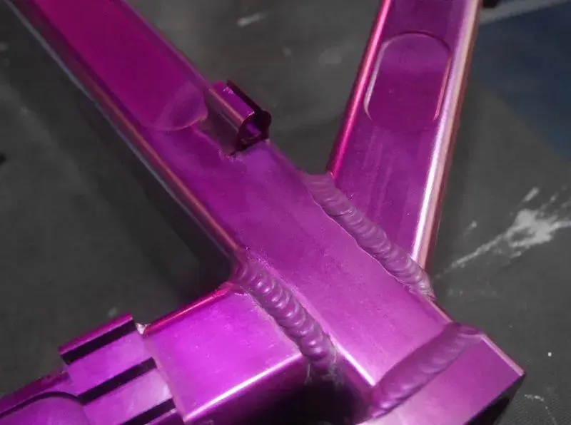

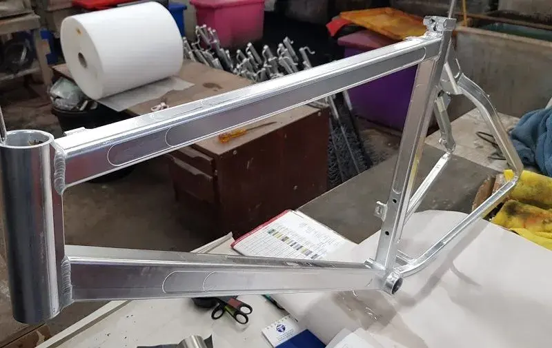

Ream and chamfer both ends of the headtube, but still looking a bit grubby, off on a journey along with some small parts (Bar ends, QR axle ends and seat clamp).
With some TLC and a professional nitric acid de-smut at the anodisers (Acorn Anodising of Sandhurst), things are looking much better:
Steve at Acorn was not happy with this prep result though, which he thought was still a little patchy:
However, the certain remedy was to have the frame physically polished or bead blasted, both of which would have removed metal and probably lost some of the sharpness of the machining etc, so we decided to go ahead anyway and see what the result was.
Once anodised and coloured, it appeared to be a little dull and patchy still, with some colour variance, especially some sort of fringing around some of the welds. Steve wasn't 100% satisfied, and was a bit disappointed too, but without more stripping then polishing or blasting, that was as good as we were going to get. :|
The small parts looked to be all OK, and a nice match for the original fork crown:
So...what to do? :|
...Knowing how thirsty and absorbent fresh anodising can be, I went over the frame with some Wurth Sabesto paint protector, followed by a couple of coats of wax/turpentine polish:
Much better. :D
Now on to re-fitting the grease nipple, bottle boss rivnuts and steel thread inserts...
