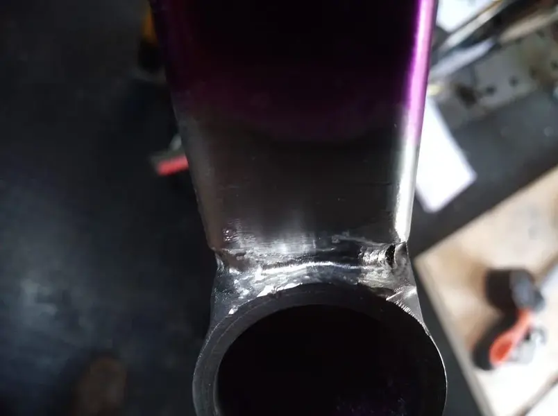

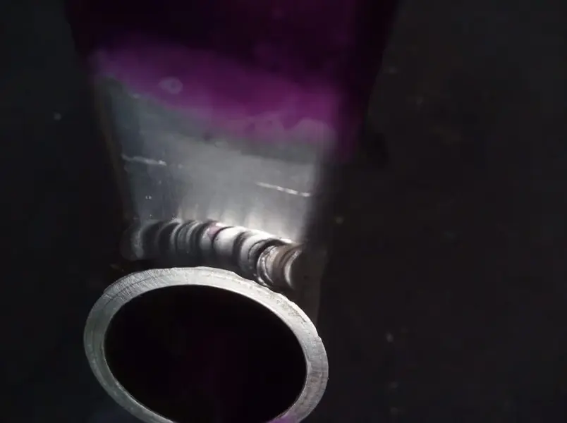

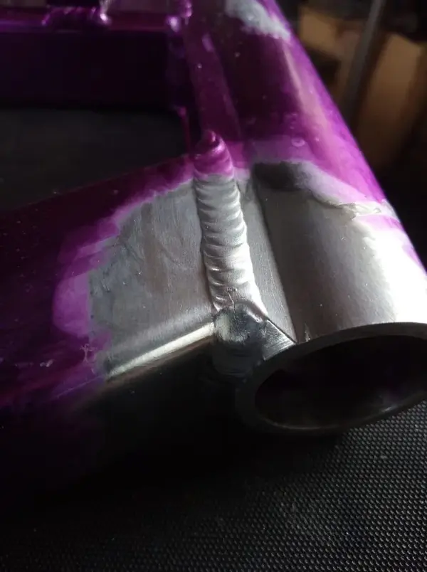

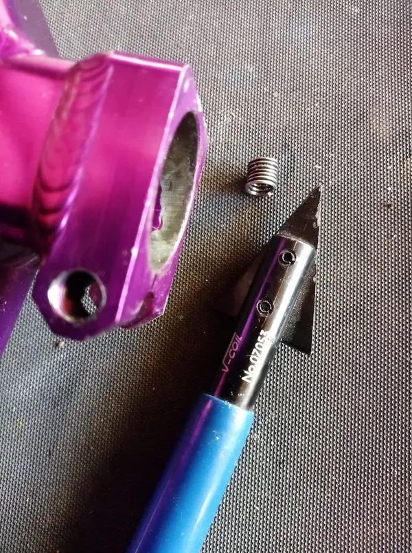

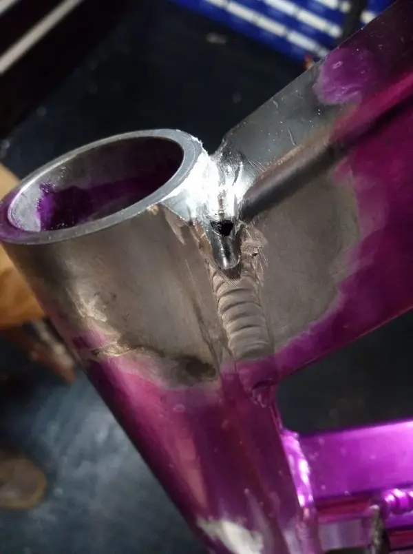

Apologies for the delay in updating this thread. Life with all of its ups and downs has got in the way but back to the point in hand. There was only one person I was ever going to ask to repair the frame and that is Dan Chambers. Thankfully he agreed and the frame is currently with him and he is applying his craftsmanship into repairing the faults. I'll use Dan's own words to describe the processes taking place
Little update: stickers and chainstays protector removed. All steel helicoils removed from seatclamp, along with bottle and crudcatcher rivnuts...Grease nipple on back of headtube was harder...needed to drill hole through front of headtube and tap out. This hole will be filled, filed back flush and covered with the new headbadge - Pics 1, 2 and 3
All snags and scrapes smoothed and filed.
Areas around cracks and DT dents etched with Sodium Hydroxide (caustic soda) back through anodising to bare metal.
Removal checked with multi meter, as anodising is an electrical insulator. - Pics 4, 5 and 6
Cracks milled out full depth of tube with tungsten cutter on Dremel so as not to contaminate with all oxide grit. Pics 7, 8 and 9

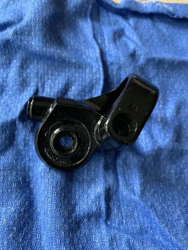

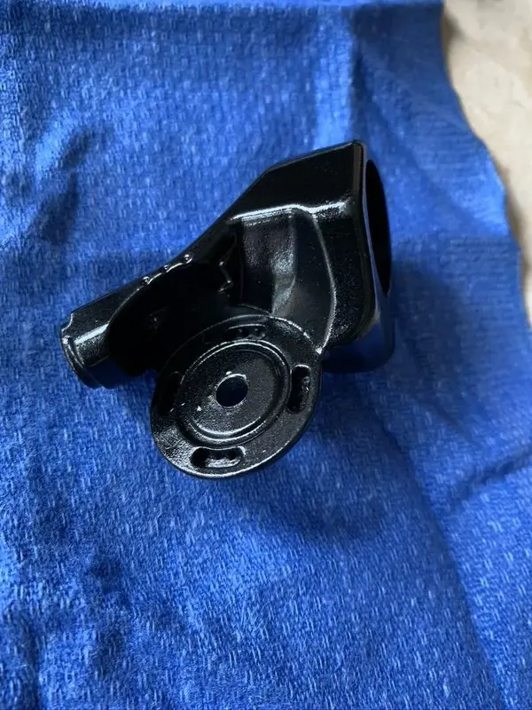

Once again Baz Napierski works his magic on my XT Thumbie clamps and a pic showing a super cool and super rare NOS Pace rear hub
