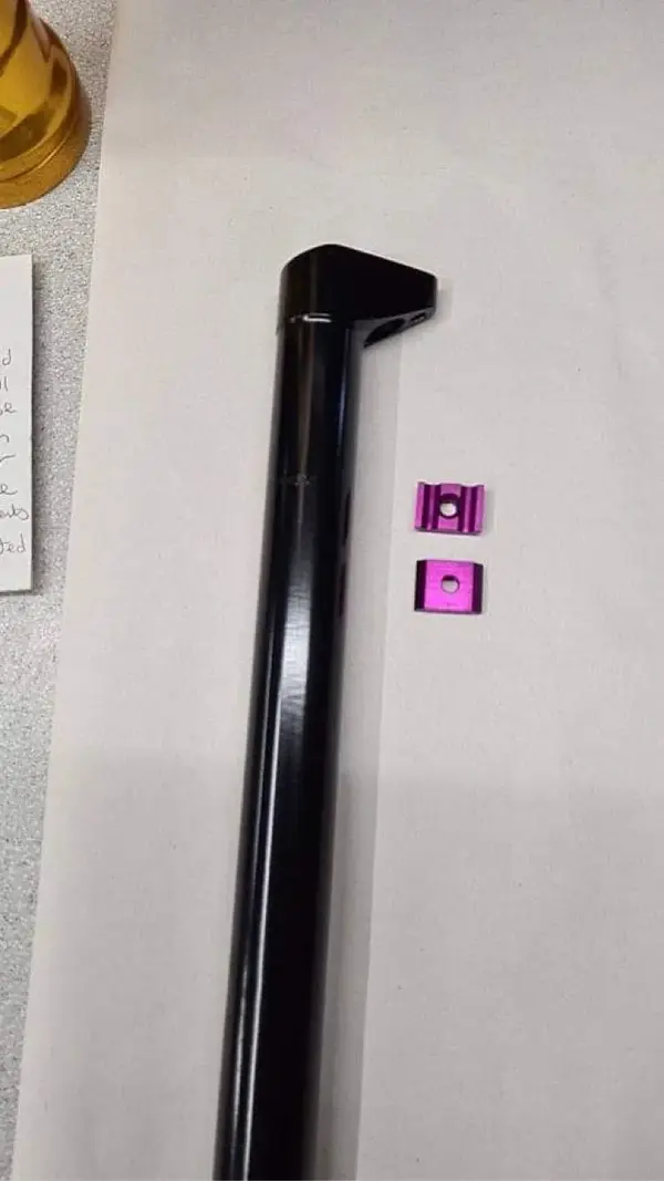

I forgot to add the straightened American Classic seatpost as well as the two custom made water bottle brackets went off to Steve at Acorn plating
I seriously can’t recommend him enough. Anyone who’s following the thread will see the amazing re-anodising of my frame, skewers and bar ends all colour matched correctly to the original fork crown
Absolutely first class work and service
