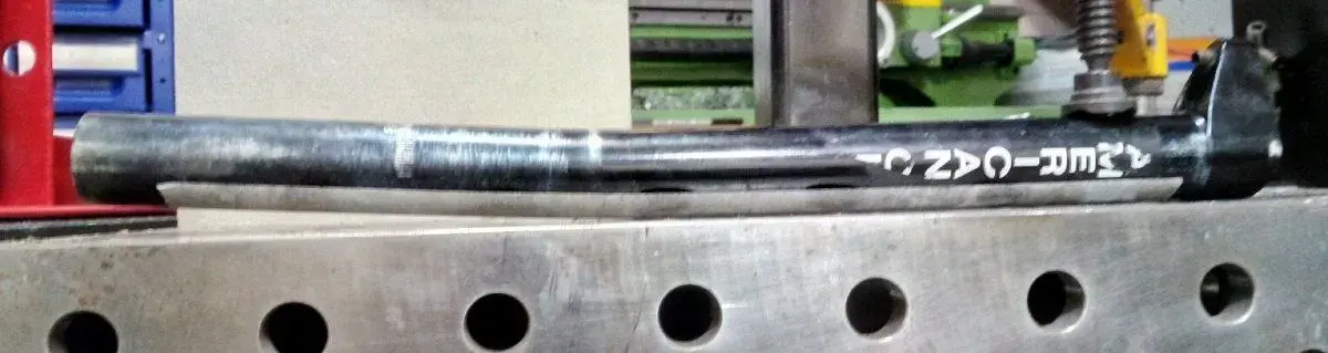

Here's the problem:
About 9mm out of plane, with a distinct tight bend over a short distance where the post stuck out of the frame.
I don't have a frame that I would want to use to replicate the original bending force, just in the opposite direction, and that would be really hard to hold and load safely anyway.
If I support the ends ot the tube and push in the middle, because the tube is of equal stiffness all the way along, it will want to bend into a U-shape along its length.
This would leave the tube in a W-shape, rather than re-straighten just the short bent section in the middle :|

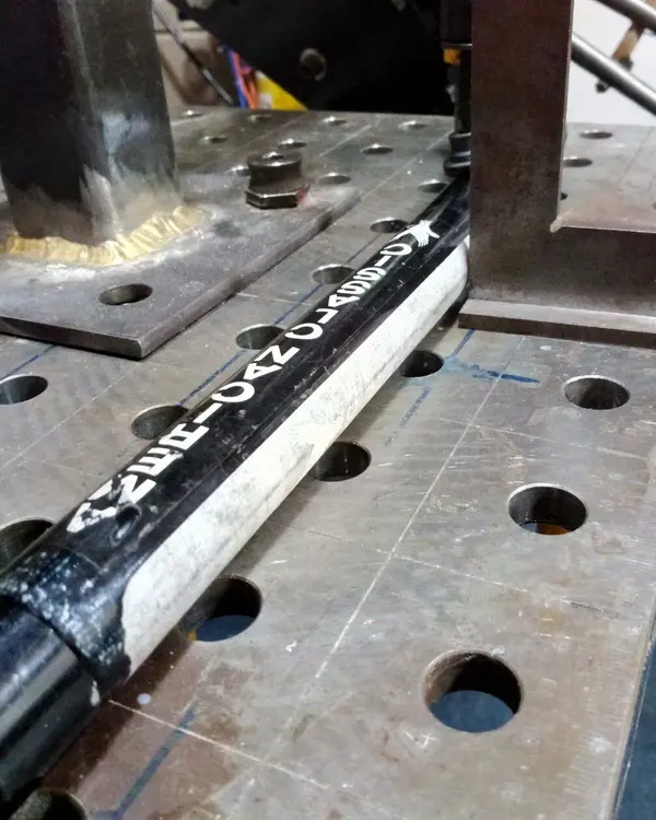

But first, to mark on the plane of the bend, and the start and finish points.
Hold the bent tube flat on the surface table and run a square along a length of masking tape on the side: And mark the bend position by eye off the surface table.

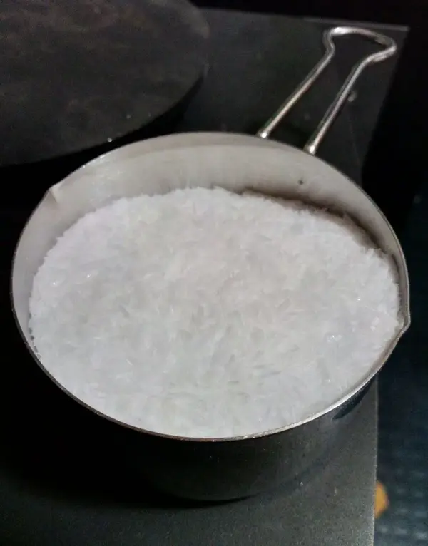

Luckily, I have some bending compound in my toolkit. Traditionally this was a low temperature melting metal alloys such as Cerrobend.
However, while mostly made from reasonably benign bismuth and tin, it also has some nasty stuff in it that's best not heated (Lead and Cadmium :shock: ), so is generally discouraged these days, unless absolutely necessary.
It has been replaced with resins such as WS8, which, in the words of the UK manufacturer is "a new technology alternative to high density fusible alloys for tube bending operations. Resin WS8 is a low density solid (~1) with a melting point of about 70DegC which can be used to fill tubes prior to bending operations. It offers excellent dimensional and wall support during bending, can be simply removed with heating and a special advantage any residue can be removed with plain water." :P
It's a white sparkly crystalline product, best not smuggled through customs:

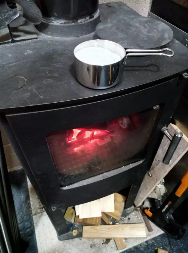

which when gently heated (on top of my workshop stove):
melts into a slightly viscous clear liquid:

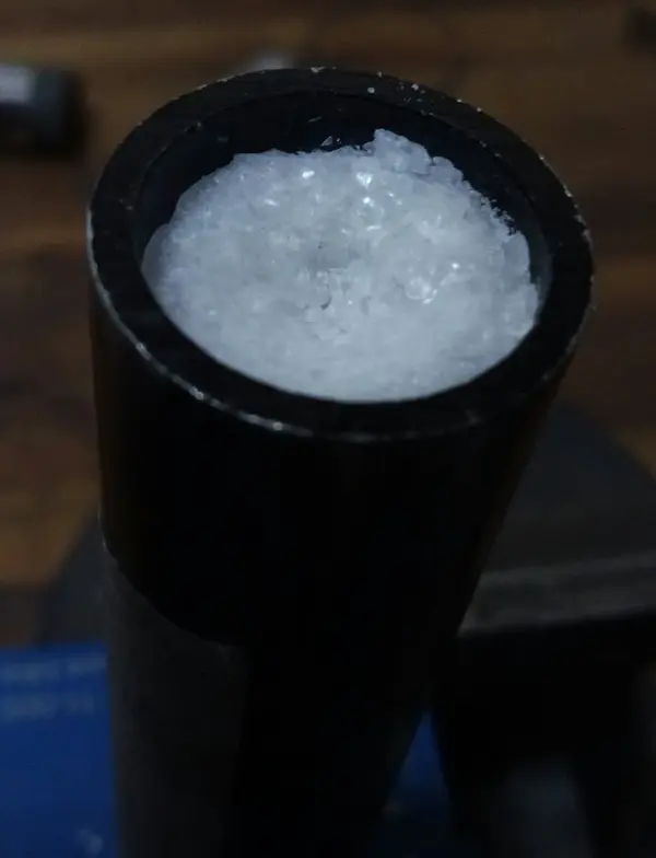

While the resin was melting, I made 2 dipsticks to test the depth of fill, because it's dark down there:
After filling to the first level mark (start of the bend) and leaving to cool, I inserted a plug of plastic foam to stop the resin filling the bent section, but still let the tube bend.
Then checked its position and length with the shorter dipstick:

Fill the second, lower section of seat tube with molten resin. You can see where it has cooled and quickly set where in contact with the colder aluminium:
Leave to cool overnight. Completely solid:

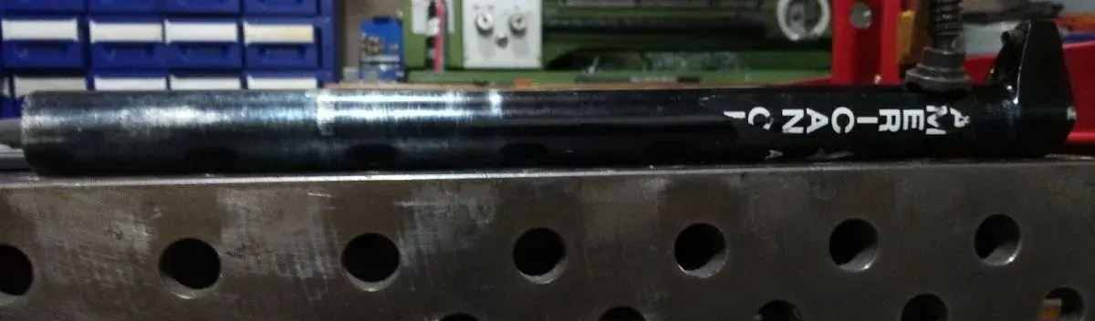

Set the piston to the top of the block and count pulls of the pump lever (so it can be repeated if necessary) as the piston loads the tube and the tube looks loaded enough past straight.
This is by eye and experience, as it will need to be bent past the straight point, as the material will always spring back when the load is removed.
Remove the piston load and check the straightness.
Ideally it's one shot only, and I certainly don't want to go past straight, and have to re-re-bend back in the original direction.
Thankfully done in just 2 attempts...nice and straight again:
Place the post on top of the stove to warm up enough to melt out most of the resin into the pan for re-use.
Rinse out any residue with boiling water.
