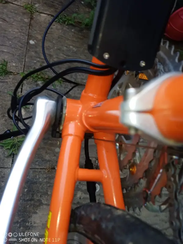

Anyway back to the bike. I did take a couple of photo's when I was putting it together as there were a couple of issues which meant it wasn't simply fir and forget.
Firstly the bottom bracket sensor on my kit is designed to lock into a normal splined drive BB cup so my Campagnolo one had to go.
And the bigger problem which may be specific to these kits with a controller built into the battery was the unit is too long to fit using the bikes original bottle cage fittings, the bottom hole of the battery mount fits using the top bottle cage which means you are at least one mounting short. I took the opportunity and added two more mounting using rivnuts so my battery unit now has 3 fixings.
So you've got a fixing up by the hole that the lock goes into? I found on my set up that was the weak link....once that pops out the hole....offski!
Not nice seeing £800 battery taking a tumble 🤔
Mines now got 3 fixings in it so I'm hoping that makes everything a bit more rigid.
