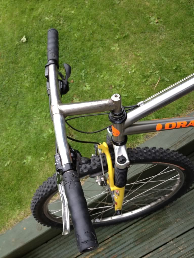

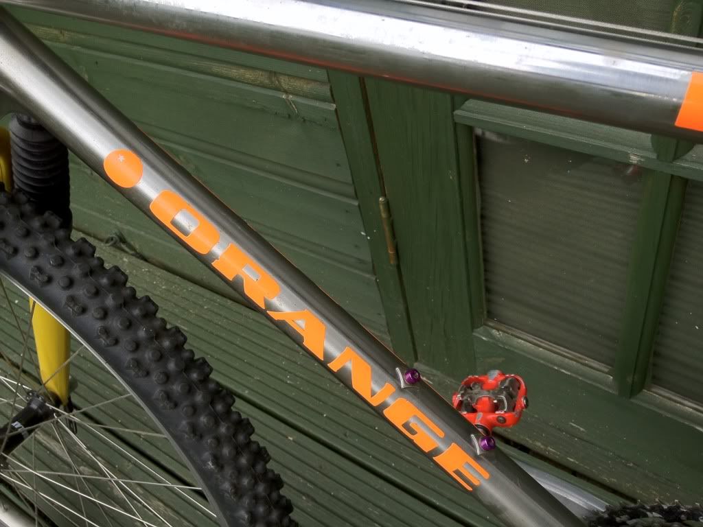

and here she is in all her nickelly & orangey glory:
I've been told these are the original grips. Sadly as you can see theres a bit of rust. It's pretty stuborn I've tried a bit of brasso and wire wool on a small section to no avail, any ideas?

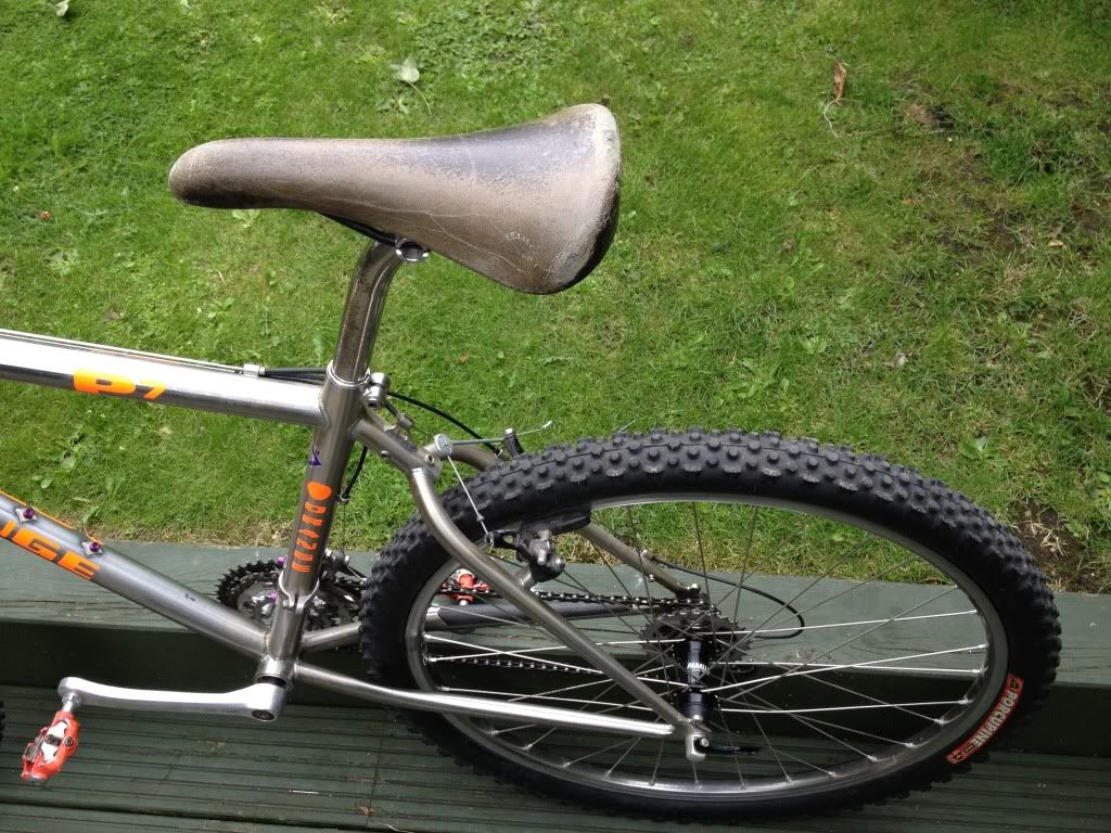

The original enduro saddle is REALLY worn as you can see.. so I'll be after one of those. Also there is really stubborn rust on the seatpost, which looks like black horizontal lines. Maybe the plating is worn off? Any ideas?
sadly can't live with these :roll:

Also, as for dating this bike I'm going by what I've read on these forums, e.g. serial number starts A9503... so march 95'? confirmation on this would be great.

Yes, it is a 95 P7, and it looks pretty good too. Always a classic.

The saddle looks as though it would be ok with a bit of leather balsam treatment. If you don't want it, please send it to me.
I think you just need to keep at it with the wire wool to get rid of the surface rust. Or you could just forget it's there and spend your time riding the thing instead of polishing it. Much more fun!

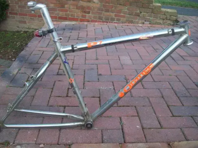

May I suggest lots and lots of Autosol metal polish ? Used it a lot on my 95 P7 frame and here's the finish. :D :D :D It will also take off any tatty bits of laquer without damaging the chrome/nickel finish. When you're happy it's worth giving the frame a good coat of quality car wax. :D :D :D

you've done a great job on that! It looks mean :twisted:

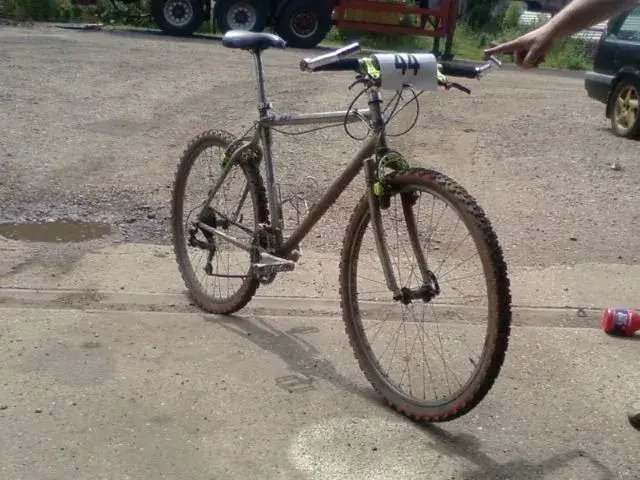

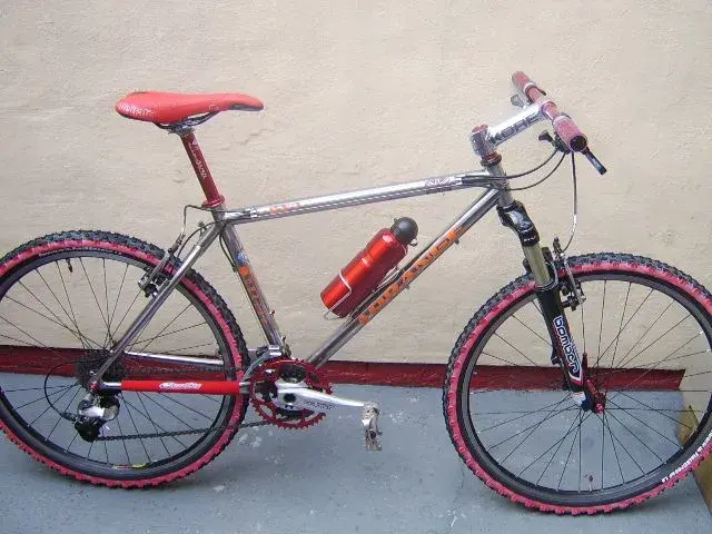

Also..... if you are unable to get rid of all the surface rust there is always the option of repainting or powder coating. I would recommend the latter of the two. This 97 P7 frame was in a pretty sorry state when I bought it on RB for £65 ( see 1st pic ). A few weeks later I found myself a local powder coater and for the princely sum of £70.... (see 2nd pic )... This is the result !!! P.S. I always wanted an "Orange"Orange.!!! :D

Haha makes perfect sense to me mate, looks really nice!
I think it's great the way you can make a frame very unique and personal with powder coating, but I'm still not sure if I'd be brave enough to cover this nickel just yet!
