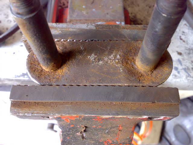

These are before and after pic from the restoration
It's just like magic.
