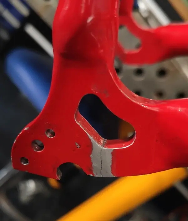

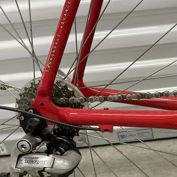

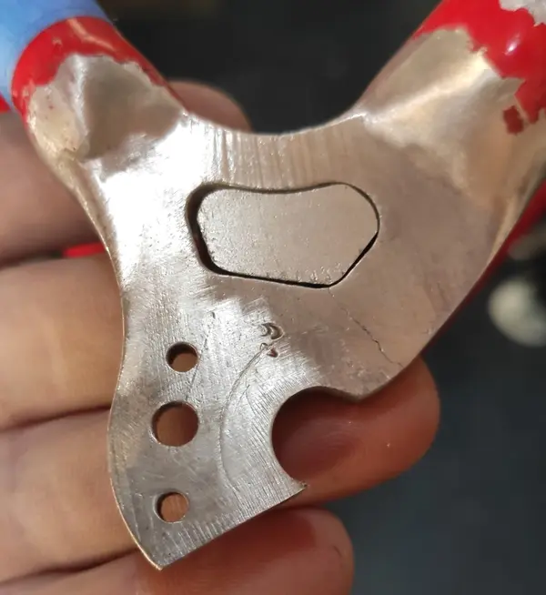

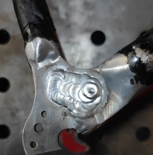

This 2002 Cannondale CAAD5 came across my bench recently.
Fantastically light (1400g for a 58cm road frame), but no wonder it cracked:
Really poor dropout design. Stamped from 1/4" plate, sharp edges with a major x-section change and hardly any vertical thickness. That short section, only 60mm², has to take all the stress and strain when welded to those stiff, fat, round chainstays.
If only they'd stuck with the simpler dropout from the CAAD3 series and not been tempted to save around 3g of aluminium :rolleyes:

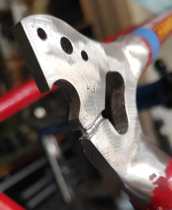

For the repair, I made up a plug for the cutout, U-cut the crack, Welded up, filed to surface, and back on the road.
IMG_20250506_154525.webp IMG_20250506_155634.webp IMG_20250507_122253.webp IMG_20250507_125756.webp
View attachment 961063View attachment 961062View attachment 961064View attachment 961065
All the best,

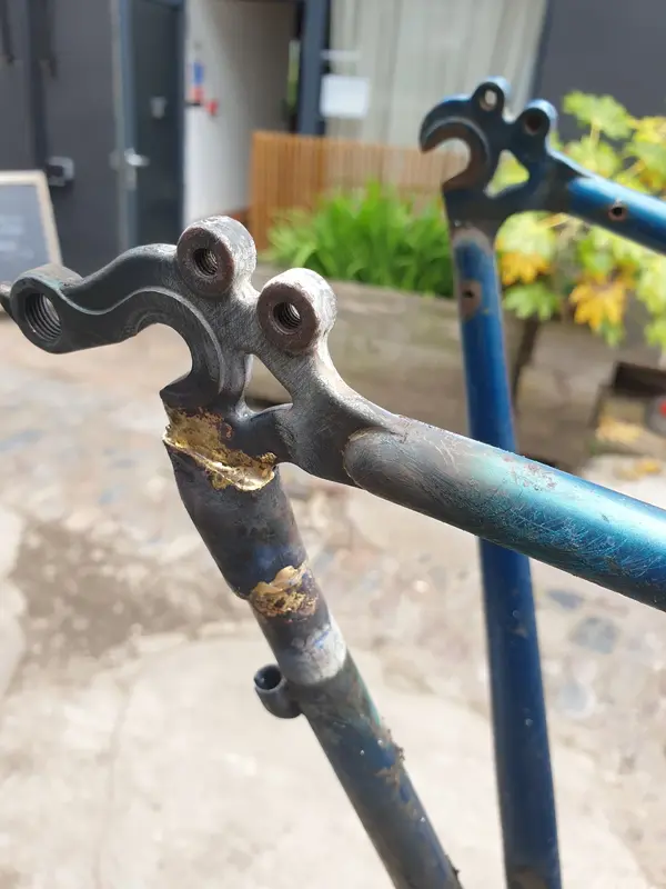

Today i had a functional 95 steel trek 730, of reasonable emotional value come in,
hardened dropout broken, same as the dale.
I brazed the crack, then wrapped a bit of stay round the tube, heated and squashed it to shape, and brazed it up.
Not expecting prizes for beauty, but I'm not expecting it to break again in that spot.
Cheap and nasty, true.
But also economical and functional🤠

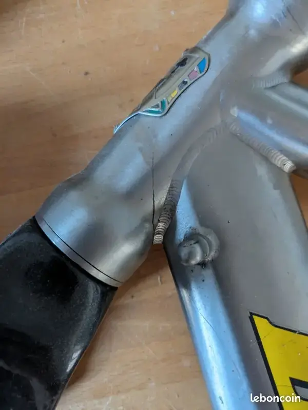

Litespeed road bike. Seem to remember a while back this integrated headtube design was not a good idea.

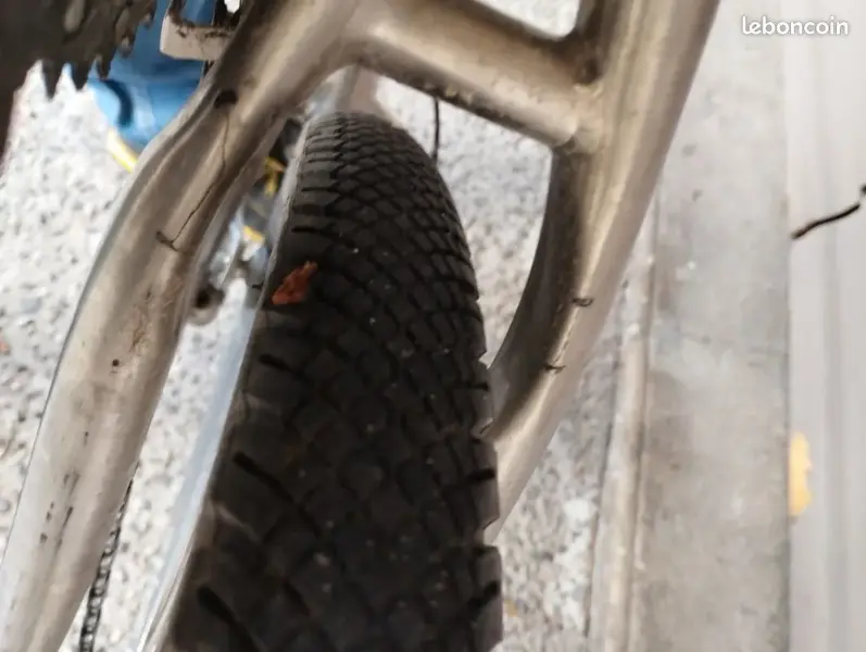

Odd failure in stereo; probably a manufacturing fault / abuse . Underside of chainstays where they are crimped for tyre clearance.
