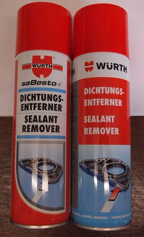

OK, so the date must be some sort of Use By date and our was short dated.
I just cracked open our next box of the stuff.
Different packaging, but looks the same otherwise, new stuff dated 26/02/17.
Bit of a mystery then, maybe down to specific manufacturer's paint chemistry.
We use Tiger Coatings and Dupont polyester powdercoats.
I'll do a little test of the two batches side by side. Back in a bit....

OK, tests done...
If anything the new stuff seems more effective, certainly thicker and clings better.
Also better result than the older stuff on some enamel paint, too.
Not sure what lacquer you must have there...something military? :D
