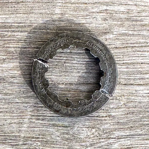

The background is that I found a nice XT R950 rear wheel for my '98 Explosif which was super-cheap due not only to a stuck cassette lockring, but because the seller had tried to remove it by grinding slots in it, presumably to seat a punch or some similar scheme.
I tried penetrating oil and mild heat, but sure enough, that lockring was not shifting. My efforts in this sort of task are always frustrated by the lack of a proper workbench and vice, and as there's no bike shop in town, I was a bit stymied. And I managed to comprehensively skin a knuckle, drawing oodles of blood, when the spanner inevitably slipped. I really didn't want to dismantle the wheel, as rebuilding it is beyond my current skills.

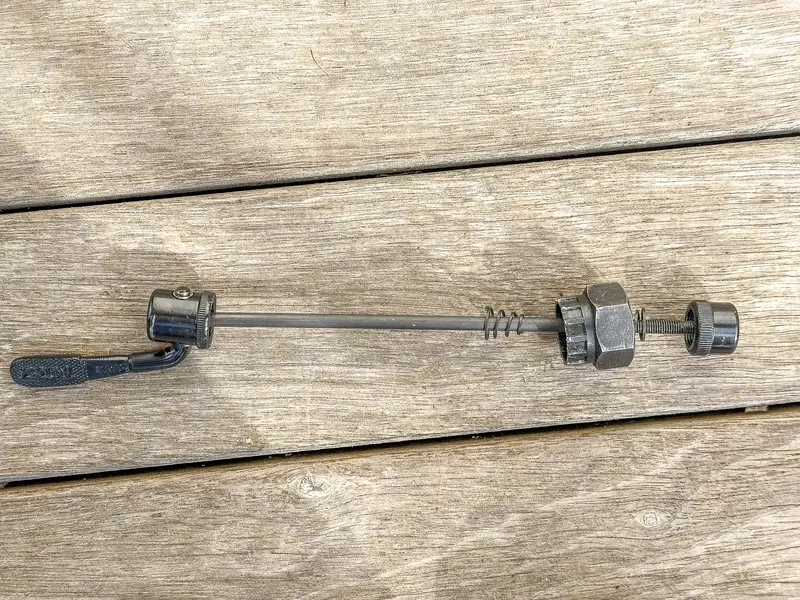

Then you lock the cassette removal tool in place with a QR skewer (I used a beefy one from a Tacx indoor trainer), place your spanner or similar implement over the removal tool, and add a breaker bar if you have one and if it's required. I also got a nice pair of work gloves to prevent further injury to various knuckles.

I'm not sure if the cassette is going to be useable again, although it doesn't seem to have suffered much to the naked eye. A new lockring is of course required, but those are easy to get. And the new wheel is now in place and working well on the bike!
