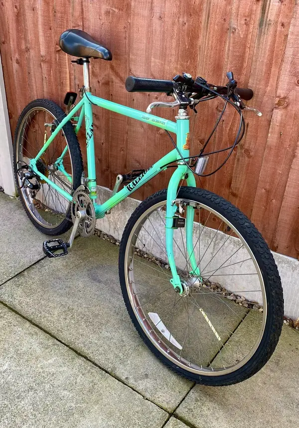

Recommissioning my old Lizard..

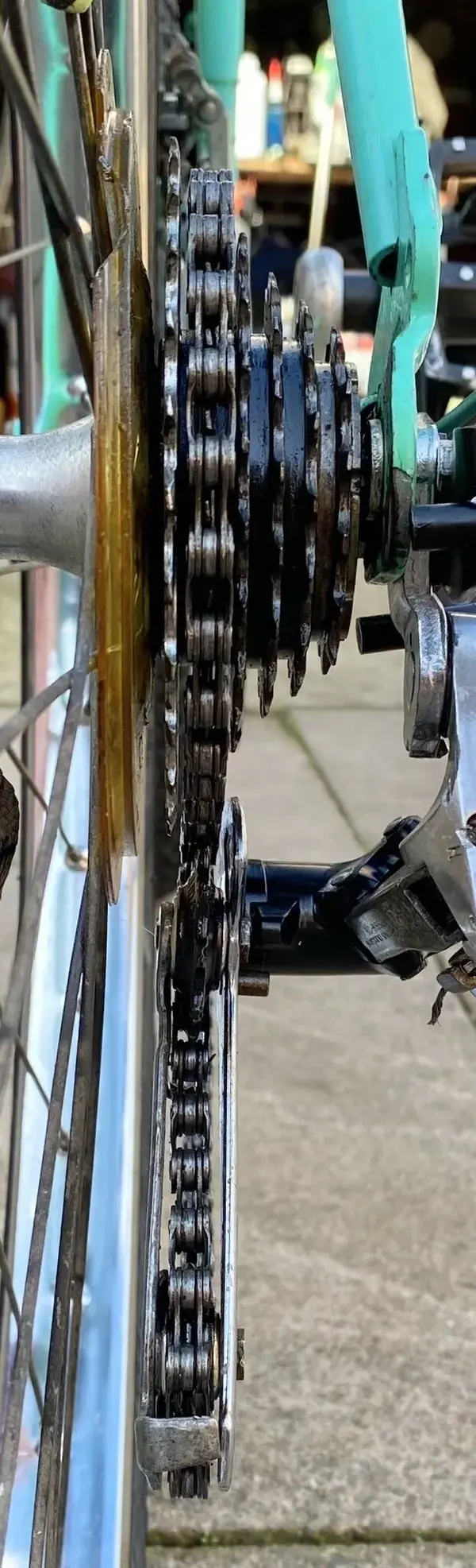

Unsure if it's just me, but the first picture I do fancy the hanger is bent inwards a touch.
Even if it's not, given the fact it may be worn out you could maybe try bending the hanger out slightly so as the cage is aligned better, as a temporary measure while you source a replacement (if originality is important)
I’ve looked again and still believe that the hanger is not bent.. I’ve taken another picture.. it’s really difficult to capture what the eye sees. But if you look at the angle of the upper jockey wheel in comparison to the cluster gears.. it’s not only cambered in towards the wheel, but also has some toe in. This can easily be rectified by pulling on the ‘play’ in the derailleur joints, but as soon as it’s released, it returns to the odd angle..

I'd have a double check of the limit screws, tension (cable and B) screws and chain length, per Sheldon. If after that it's the hanger and / or the mech' you'll have eliminated those variables:
"Derailer Adjustment" https://www.sheldonbrown.com/derailer-adjustment.html
Thanks for the link, I will double check the adjustment’s just to be certain that it can’t be rectified, if only temporarily 👍🏻
