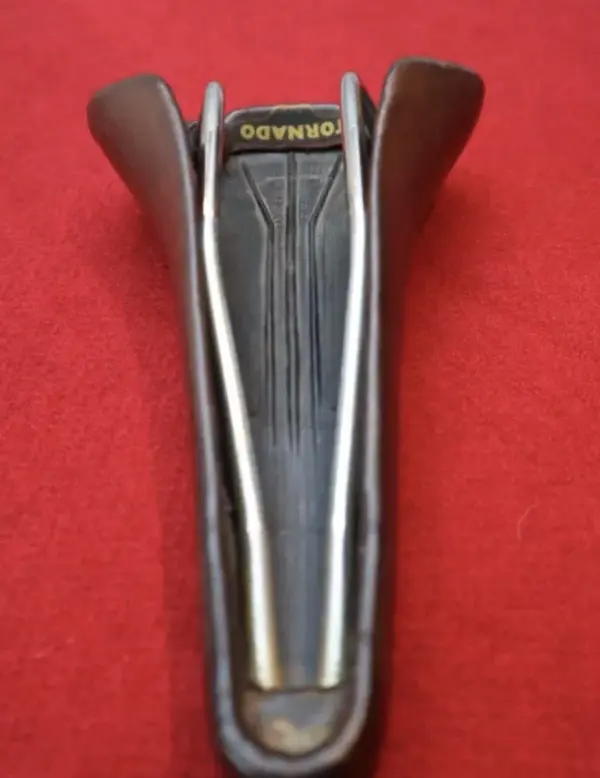

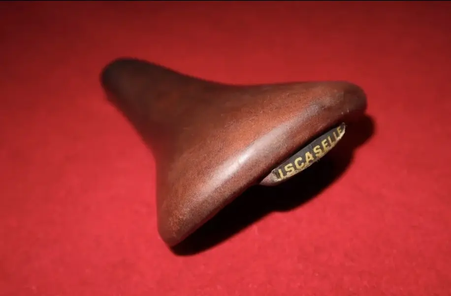

A decent brown Iscaselle Tornado saddle appeared on eBay and I couldn’t resist putting in a bid. I won the auction and it was delivered today. That went straight on the bike. I liked the old Brooks it had on it but the Tornado suits it better I reckon. I believe the Team Replica 12 and Road Ace 12 in the Raleigh range of 1982 had a Tornado saddle, so a bit of an upgrade for the RRA. It’s in better condition than the listing pictures would have you believe.I think it’s older than the bike, it has the cloth like stickers which says 70’s to me but what do you guys think?
