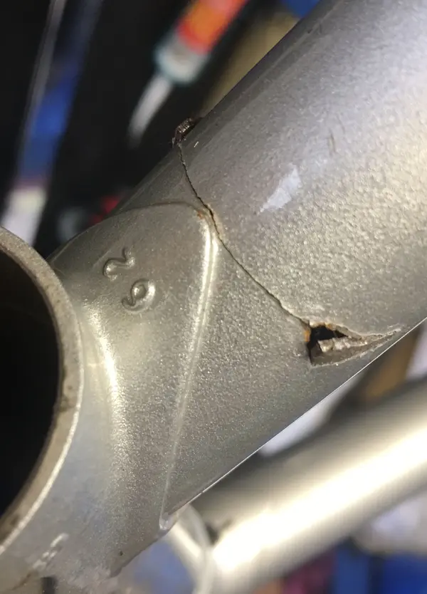

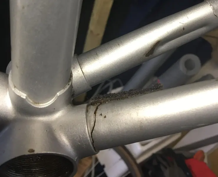

Alas my 708, mentioned earlier, has died.
No incident, no accident, just simple metal fatigue....
Or was it. Closer inspection shows some curious facts.
1. The lower seat tube should have multiple facets on the internal profile - it has none
2. The chain stays have the multiple facets. Reynolds make no reference to this.
3. There is a zinc rich primer inside and out and no corrosion whatsoever
4. It has done 5000 trouble-free road miles in my ownership, never crashed, bashed or pot-holed.
Raleigh cooperated with Reynolds to develop this tubing. I am going to investigate and see if this frame was part of that process.

That’s 5k miles no 50k. I think that’s pretty lousy and less than a years use for many people. Sure it might have had a hard life before me but it’s condition when I received it didn’t tell that story. It’s a tubeset that is designed to be loaded up with luggage and rider. It’s never been loaded in my possession and I am only 75kg. But given what I said in the previous post, maybe the gauge of tube isn’t standard after all and it’s not as durable as you might expect.
