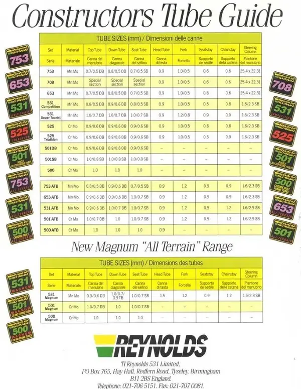

What that build did show me was how good the frames are. The 708 tubes are heat-treated mang mol like 753, but with a larger diameter top tube and ‘special section’ internal bracing to increase strength [8 internal flat sections according to wikipedia].

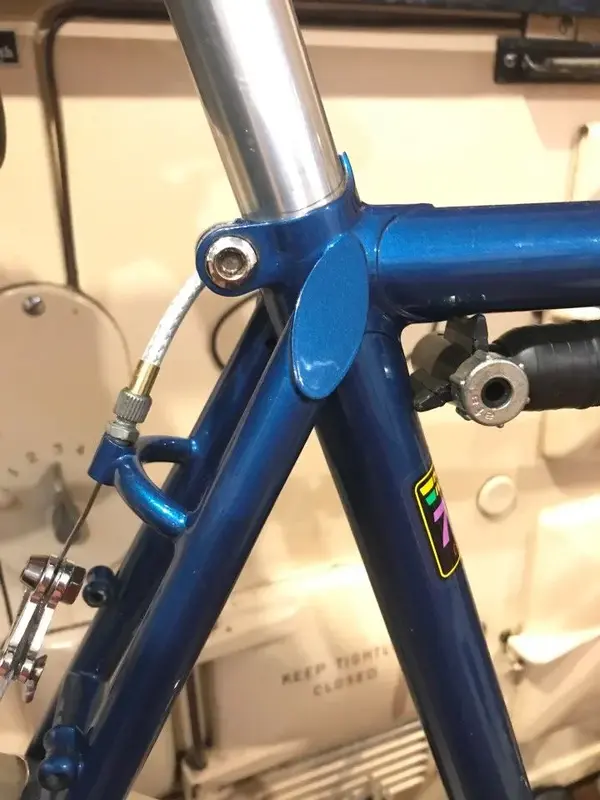

For me, it it’s the 708 versions that epitomise the marque: innovative materials worked into a great design with brilliant signature touches that add a bit of iconic cool: oversize seat stay caps, spoke holders on the left stay (531 frames were on the right, 708, left); no chainstay brace, but instead a cool "pip" for mudguards; 135mm rear end.

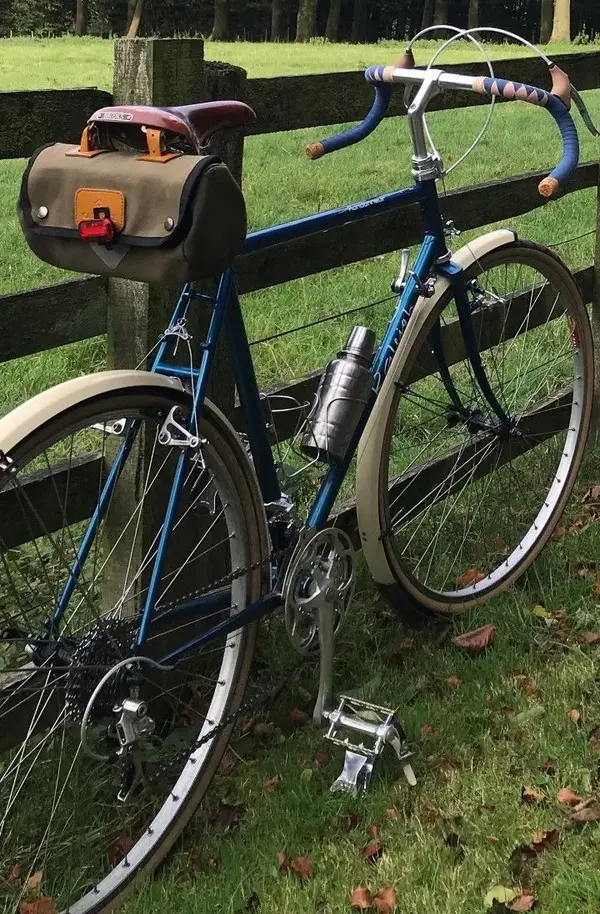

Mine is an H serial number which likely equates to 1997. serial no. linky But I’m not wedded to catalogue correctness and it’s been built with a, er, retro flavour: Specialized BB1 flared drops held high on a nitto stem; non aero brake levers, Swift Ti saddle and 9sp Dura ace shifters on the down low; MKS flats with clips and straps. Wheels are stock, and while the black parallax hubs don’t really fit, they can stay until they wear out or I splash on a dynamo hub.

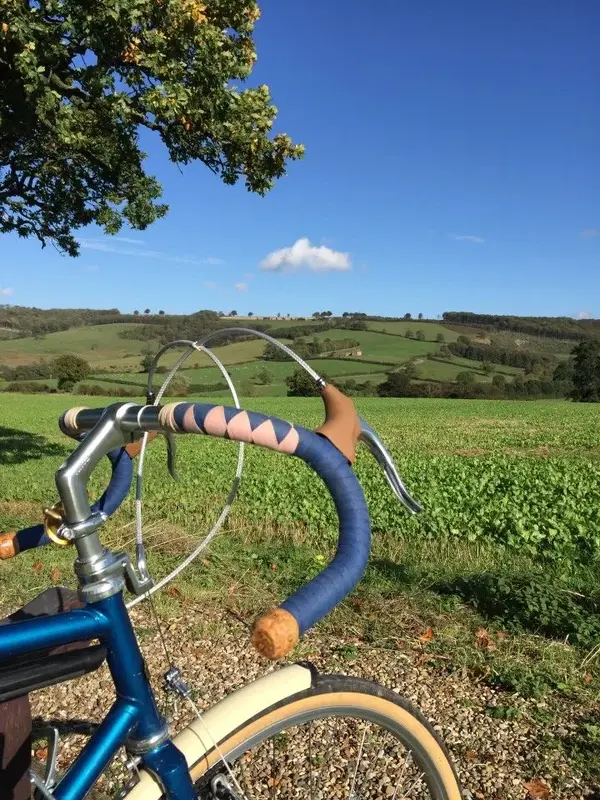

“Mashup” brake levers. I’ve had a few builds with drop levers and cantis, and while there are some good performing levers, they are usually too modern or aero. So initially I opted for dia compe Gran Compe 202s which look great, are non-aero and have groovy adjusters. But once fitted they were just a bit too flimsy and squishy - not as positive as some old Shimno 105s I’d used on an MTB drop bar build a few years ago (SLR cable pull and sprung levers). So I dug out the 105s cleaned off the logos, transferred the hoods and adjusters from the Gran Compes and voila: well sprung, nicely modulated and powerful when hooked up to proper wide-profile Tektro cr720s.

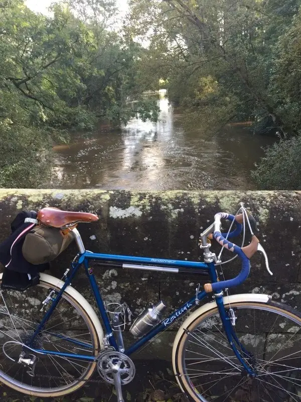

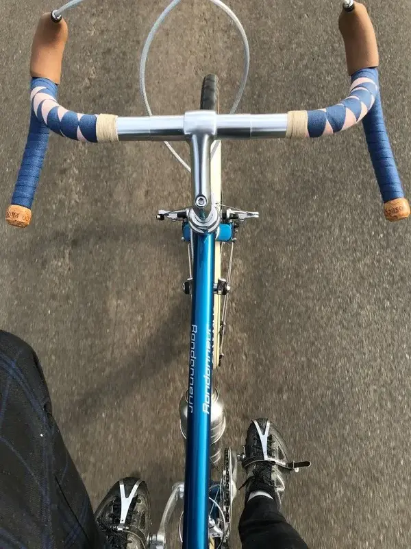

Ride.
The more I ride this the better I like it. Its the balance between practicality and agility that stands out. The frame is comfy and responsive. It’s stiff enough not to feel noodly under power, and light enough to build into a quick bike that doesn’t hate hills. The steering is quick too. This is accentuated by the short stem and relatively narrow flared bar set up I have, and I considered using a wider Nitto Randonneur bar. But I love the BB1s and will just man up. It’s rock solid down hill too. Apart from an eventual upgrade to a dynamo hub wheelset, the only changes I’m considering are moving the shifters from the down tube to the stem steerer. This grieves me somewhat, but I have to acknowledger that on long rides I’m getting an old-man-ache-on-one-side from reaching down. Perhaps Yoga is the answer ….
