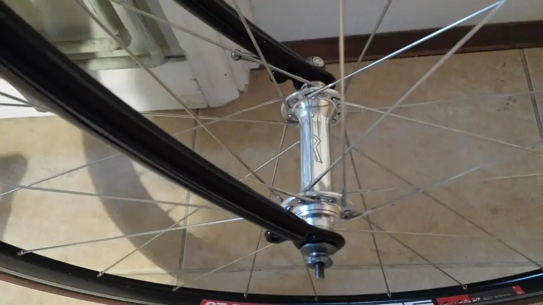

Just had a look at the wheels on my other Raleigh 753 Dynaflite built a few years ago by DCR Wheels. Bit more of a fancy build up with 28 hole Campagnolo Record hubs radial front and 2X over over drive side, radial non drive. With all of the under under wheels there is quite a gap between the spokes where they cross.

with radial spoking, should the spokes be laced from inside to out or outside to in?

Another question:- What years were those Campag Record hubs the ones with the oil hole clips.
My Mercian has large flange ones and that's a 1982 build and I've also got a random small flange front one laced onto a NISI Mixer clincher rim that's been hanging up for ages - wondering if it's worth anything as a wheel, very good condition.
Campag's not my thing as 50s Raleigh didn't use it (unless it's AOs bikes!).
Everything Campag I get I swap or sell.
Year will be on the outside face of the locknuts. Depending on the number of holes will affect the value...28's more money than 36's...24's rocking horse poo..£££. Condition and the correct skewer adds value. Check sold listings on eBay for pricing, maybe better to cut out and sell hub and rim separately.
