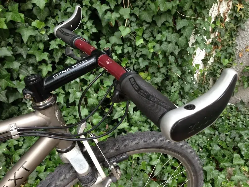

Were the Dyna-Tech Torus XT's stem and handlebar also made of titanium?

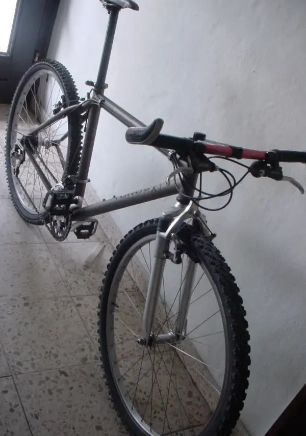

Would it be possible to install a modern suspension fork on such an old frame without changing the geometry too much?

Torus XT came with a ti bar and cromoly stem.

Thanks. My Torus has a "Suntour SR Duotrack 8001" fork installed, but it's broken. The distance between the wheel axle and fork crown is about 385 mm, but modern suspension forks have much longer distances of 450 mm minimum. Any older suspension forks that can be recommended?
If it is broken would the a-c have been longer?
Older suitable forks would be Marzocchi Bombers and Rock Shox Judy. I have 440mm rigid forks on my Torus and love it!
Have a lookout for Marzocchi XC range forks - particularly XC500, or XC51. Not great for heavier riders tho - so depends on your weight combined with the bike.
Fork weight is around 1.3kg and they are air-sprung, so no nasty elastomer issues to worry about - just check the air seals. Most - unless anyone changed the brace - have canti-guides, travel is 50mm and they are same era as the bike!
Steerer tubes are replacable bolt-in/out, so can be swapped if too short or long, and if you're lucky they did both XC500 + 51 in the same colour as your frame - so keep a look out :wink:
Oh, I forgot that... yes, it would be a bit longer, 410 mm instead of 385 mm. So 440 mm is no problem? Is this a limit or could even more be possible without changing the steer angle too much?

Which is the maximum spring travel that a Torus XT frame allowes? Does anyone know?
