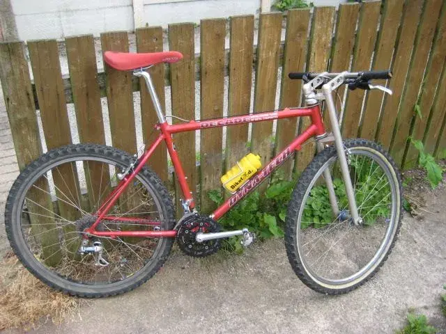

About that Decade does anyone have one for sale? Massive long shot I know!! I remember stumbling upon it in an MBUK at the time and thinking if only....

There was a Decade here on sale a few years back - but they’re as rare as hens teeth
There was also a custom painted (in Raleigh SPD factory) green MT5! And that’s the rarest of the rare
As I said - will be buying a Trimmel from Tomas - then going to build her up - won’t be a Dynatech Decade (as I believe that had the same Metal Matrix frame as the MT5) but it’ll be sweet!
bikemeister2000":14vandio said:
The Decade became the MT5 frame and had MMC maintubes in BP XMT100 composite (Aluminium with silicon carbide whisker reinforcement)
The MT4 had Titanium main tubes.
If you stripped the main tubes back on MMC it would look like a dull grey colour.
