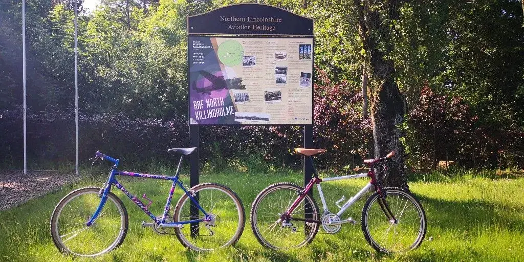

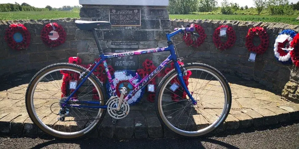

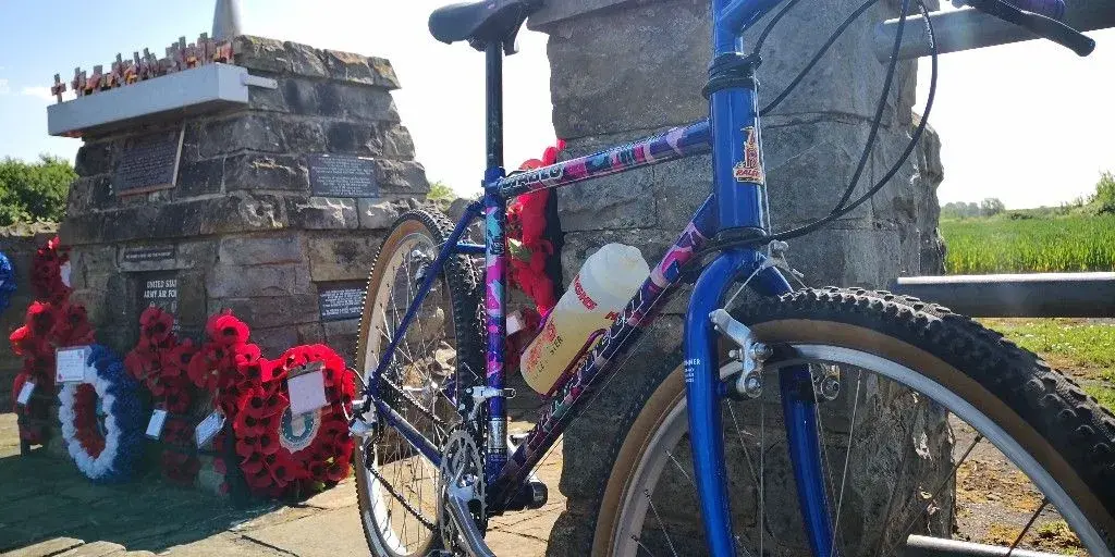

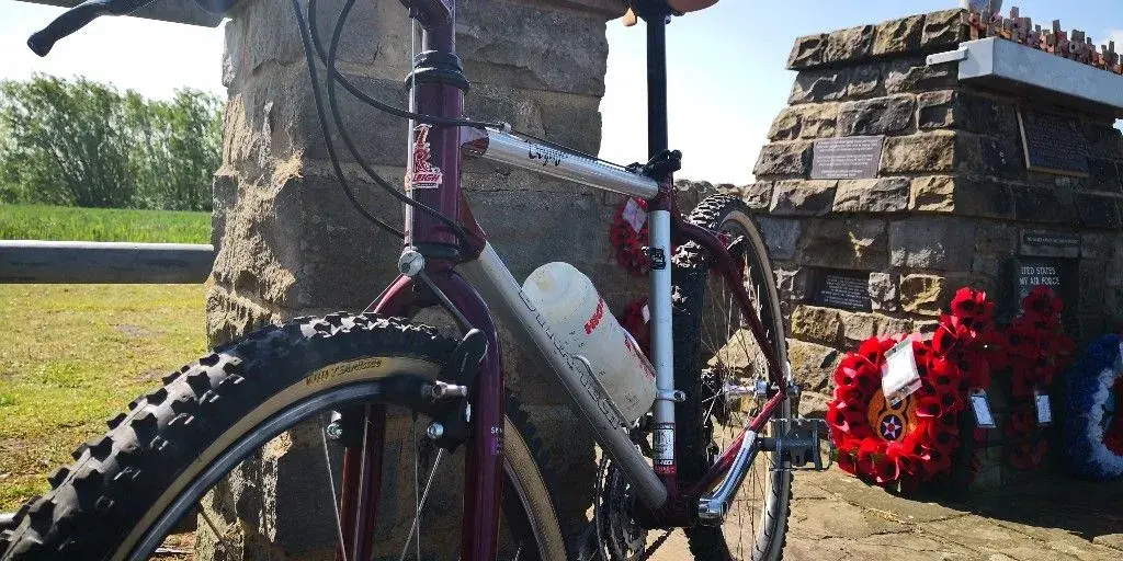

Ride out on the Dyna-tech's together with my lad,so fast and cool 8)

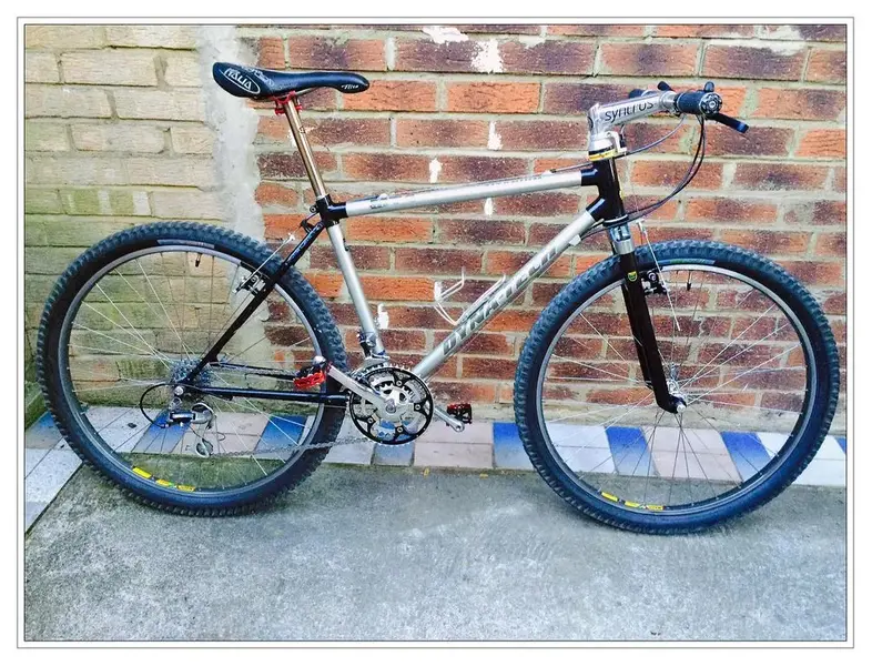

This is what I used to have
I still have the frame headset (Mavic 316) and bottombracket (Royce)
Hoping for M900 throughout (mine here had XC-Pro and Paul’s)

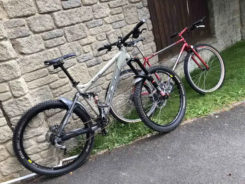

This is what I’m Aiming for - the Dynatech In the Pace factory! Except cos of the BB I have mine will have a cook E cranks again - but you could consider the ones on this pace factory bike (or Cook racing CBR) look superb

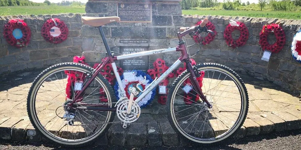

There Stunning mate just hope I can get the bits I want I already have a a guy with a pair of nos Campagnolo stheno rims just need to find some xtr m900 hubs now
first ride on the Diablo think I may need longer arms :D couldn’t stop smiling thou epic bike couldn’t get over the size differences to a modern ish bike
