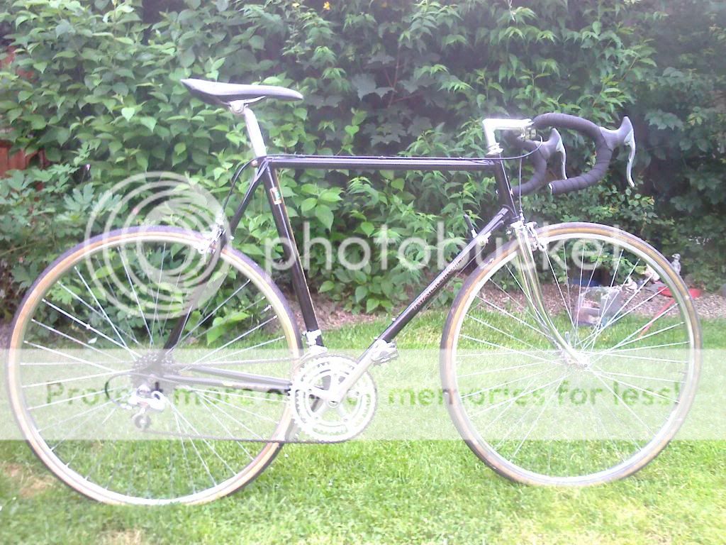

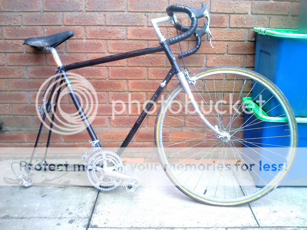

I bought this Raleigh Criterium off EBay a couple of weeks ago and It's cleaned up ok.
I bought a second hand rear wheel from LBS, and put a new tyre on.
Fitted new chain and bar tape.
Saddle from my spares box.
Does anyone know what year its from?
I would like to return it to standard.
How could I find the original spec?

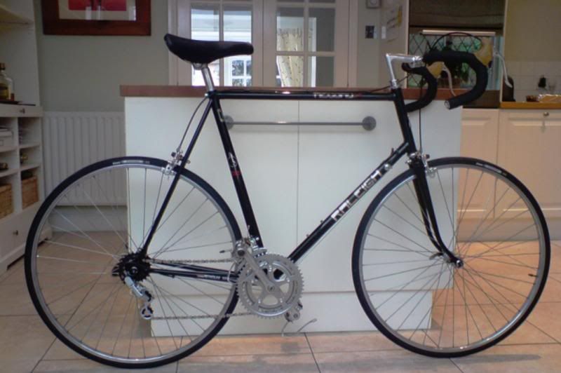

I've had a look at the brochure's and the frame (not forks though) rear chain stay decal and seat post would suggest it is one of these:
A 1983 Record Sprint
However, the components are 'normally' gold on this bike!
The brake calipers and chain set look to be the correct ones, albeit they aren't gold
The downtube decal is from a 1984/5 Raleigh Competition
Curious
Rear dropouts are wrong for an 83 record sprint, unless raleigh did a weird transitional thing? Mine had a normal horizontal one on the driveside, this has the one the Aerospace bikes had.
All the rest of the frame details fit though, same lugs, clamp on front mech, bloody awful seat clamp bolt, etc... No idea where it got chromed forks from though.
Chainset is def not the Record Sprint one in silver.
Friday Afternoon Special?
Bats, apologies, I've just looked again at the chain set, my mistake
The chances are it could be a transitional model indeed.
Raleigh made a Record Sprint SE when the aerospace contour model was available, which was the same frame but with all silver components, including the lesser specified Custom steel chain set. The decals were the same, albeit finished in silver instead of gold.
This could have been something similar
Never heard of an RRS SE! But that it existed explains a few things, like why I can only find silver decals.
Either way I quite like the look of the chrome fork on this one. SMD what are the frame angles?

Thanks for the replies.
It has a small faded "Criterium" decal on the top tube. Looks like it was gold.
The paintwork is black.
The brakes are Weinmann "type 500" , brakes are Shimano EX500, front mech is Suntour 7, rear is Shimano RSX and wheels are odd 27 x 1 1/4 !
Any pics of the Criterium decal?
I'm pretty sure it's been re-decaled at some point during its life...
