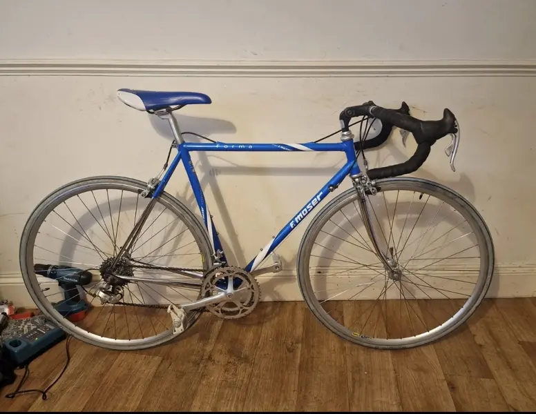

I’m going to try to make this my last purchase of a complete bike this year
I think it’s a 1994 model, hard to track down info on these.
I thought this was worth a bid and won it, either got it cheap or there’s no love for some Moser’s.

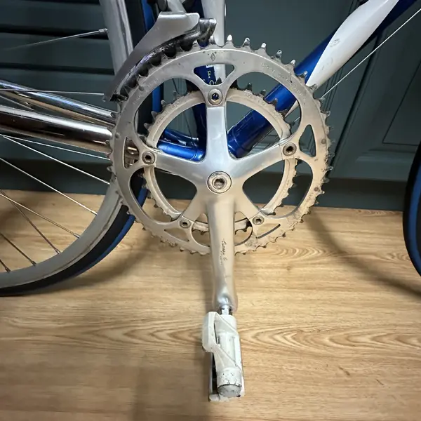

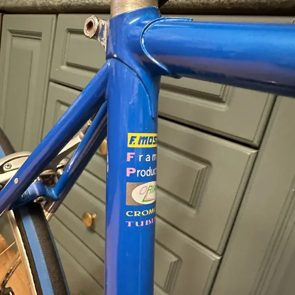

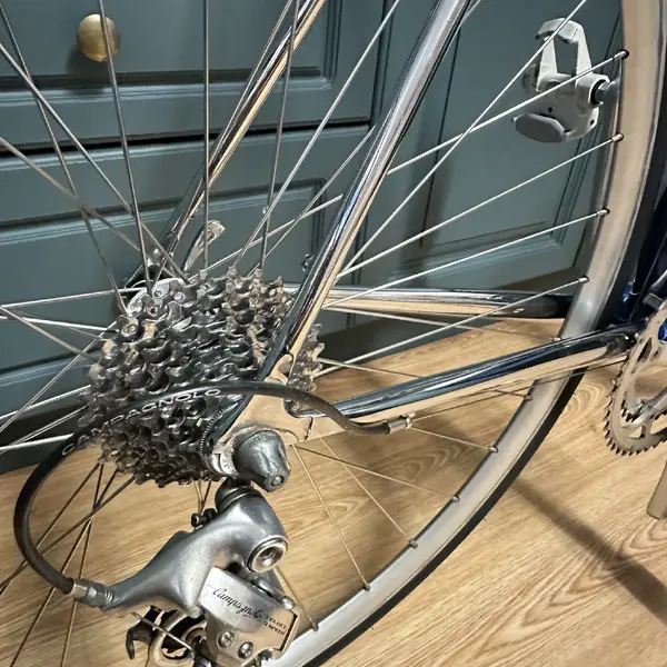

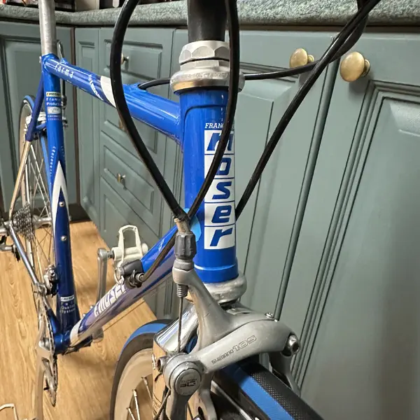

This Moser has Oria chromoly tubing, Veloce 9 speed group set apart from the 105 brakes, it’s lost its original stem and seat post at some point. I’m not sure if the CXP rims were spec or not. It came with a blue and white Vuelta Kolor saddle which has already been swapped out for a Turbo, the Kolor might go back on. The Michelin tyres were perishing, so the Schwalbe Blizzard Sport’s were fitted as a temporary fix, they were takes off’s from my Cadex.

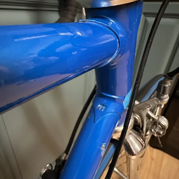

A Cinelli XA stem has been bought today, that will look loads better with the Criterium bars it has. The seat post has been cut down so I will replace that in time. A new chain will be needed too. The non drive side rear dropout slot had been closed up a little, probably in transit. So I had to gently persuade it back into shape to accept the rear wheel. The chrome is lovely and obviously the paint has some marks and chips but nothing I can’t live with. White bar tape will be fitted when the stem arrives. The white early Look pedals seem fine so will stay in place for now.
