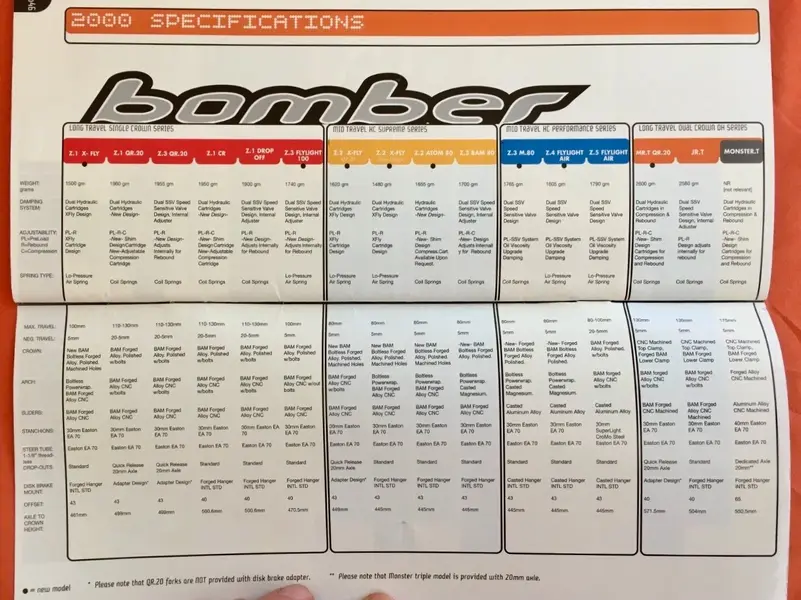

I just found this page from the 2000 Catalog that I think it's not available in the Public Repository, so enjoy!
Correct : I'm missing some catalogs 2000, 2001 2002 in my repository : Check my Marzocchi Manuals Repository : https://public-repository.org/
I bought the paper version from the 2000 catalog @ Ebay and it just have arrived last weekend. I will scan it later and add it to the repro.
