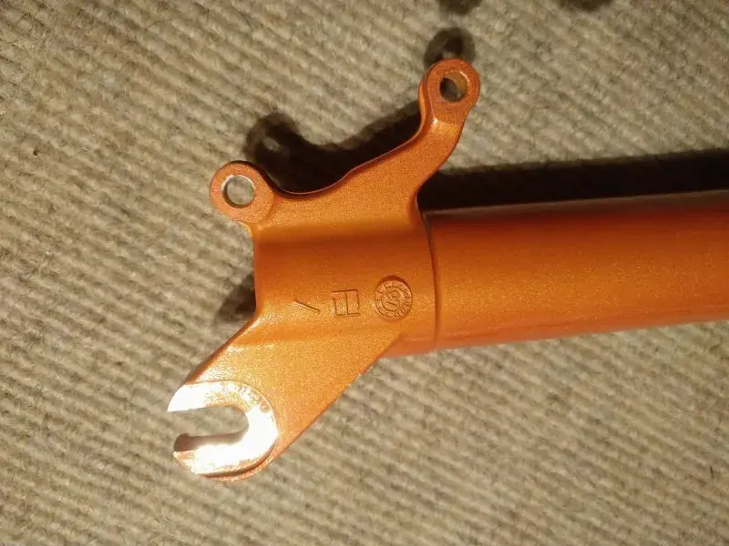

Hi Biker,
have a look at this picture, it shows a pair of hydraulic cartridges from a Z1 BAM with 100mm travel, the casting is from 97. I'm not sure all parts are from 97, but anyway.
My question is a bout the differnce of this cartridges. I have 2 other Z1, a classic Z1 with 100mm and a Z1 BAM with 130mm, both are using 2 identical (silver) cartridges - this is what I found also in all the Z1 manuals.
This Z1 Bam has a red one and a silver one. It looks and feels like the same, they both have the hole in the bottom, but when I compare some pictures from spares, packages are labeled :
- red cartridges: --> Rebound Cartridge
- silver cartridges : --> Compression Cartridge
I believe Marzocchi changed somehow the cartridges in about 1998 and put a red and a silver one into the forks?!
Can someone of you gurus please advice? What is the difference of the cartridges??
Thanks for a note!

Hi, after some tests with about 5-6 cartridges from Z1 forks I can't reproduce any difference in rebound/compression. All this cartridges I tested slide in easily and are 'damoing' somehow, depeding on the knob adjustment.
I did the tests with a small glas, pumped the cartridges full and tried to find out by moving up and down (while bottom part was still in oil), in which direction I need more force.
For me all this cartridges are the same, but some are red coloured.

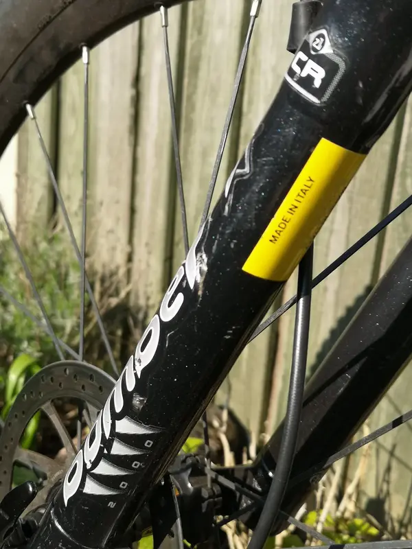

Z1 cartridges are both rebound cartridges, as far as I'm aware. The exception is the Z1 CR fork, this has separate compression and rebound cartridges. The rebound cartridge has a silver screwdriver slot, the compression cartridge has a black screwdriver slot for adjustment. I've a set in the shed so I can take a couple of photos if you're interested.
The compression cartridge was introduced in 2000 and could be retrofitted to some older models.
Evidence:
From the tech docs
Adjustable Rebound Cartridge
Found in 2000 model Z.1 QR 20, Z.1 CR, Z.2 Atom 80, Mr. T QR20, Jr. T, Monster T, 1999 Z.1 QR 20, Z.1 BAM, Z.1 Alloy, Z.2 Atom Bomb, Z.2 BAM, Z.2 Alloy, Mr. T, Monster T, 1998 Z.1 BAM, Z.1
Alloy, Z.2 Atom Bomb, Z.2 BAM, Z.2 Alloy, Mr. T, 1997 Z.1, Z.2 " Adjustable via external adjuster
" Allows rider to tune rebound speed to coordinate with spring rate " Proven design.
Adjustable Compression Cartridge
New for 2000 is our adjustable Compression Cartridge found on the Z.1 CR, Z.1 QR.20, Mr. T
QR.20, Monster Triple " Adjustable via external adjuster with infinite adjustability " Limits ‘dive’
under the compression stroke " Tune out ‘bobbing’ during sustained climbs " Sophisticated shim
stack design features a high-pressure blow-by function that eliminates hydraulic lock under hard
hits " Shim stack design also protects valve and cartridge body from damage under heavy forces
" Compression Cartridge allows rider to tune compression feel to match body weight " Retrofits
into ’97, ’98, or ’99 fork models where applicable

My pleasure! The rebound adjuster is standard colour etc, the compression adjuster is black. Pictures should be attached.
