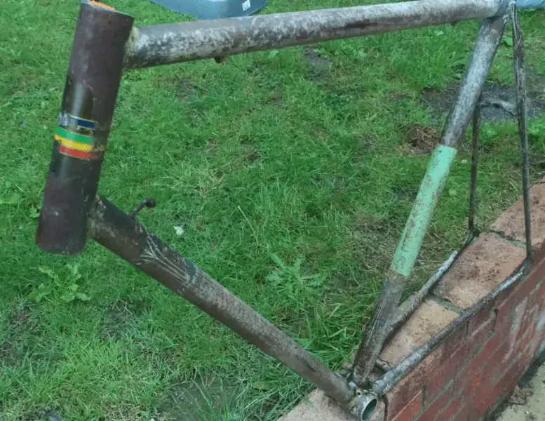

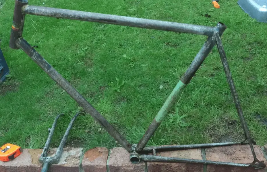

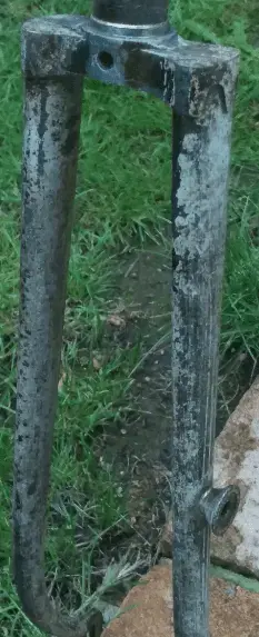

Made a start on the rust, Evaporust and wire brush so far. There are a few areas where pitting is quite deep, but nothing structural so far. Can see a lot more of the original Paint work now.
