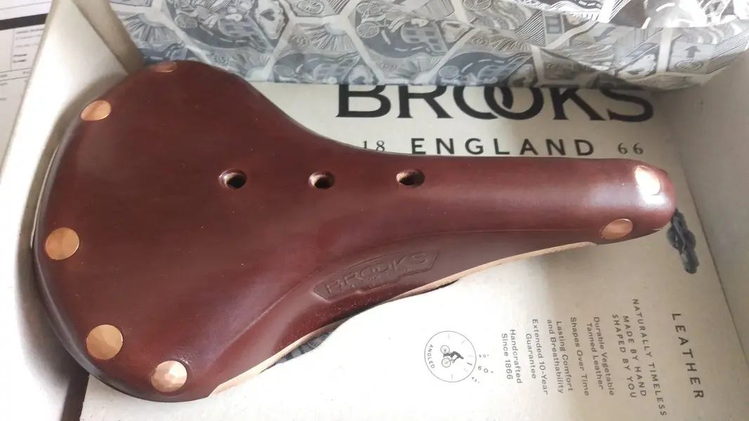

Could be getting a bit ahead of myself here, but forked out for a Brooks saddle for the eventual re-build. Don't really need it yet, but the B17 Special looked nice even if not totally original; it weighs a tonne!. Never had one before so will be nice to see what they are like. Also got some Allez pedals and will use some nice alloy Wolber 27" rims from another bike purchase, might use the tyres too as they look ok.

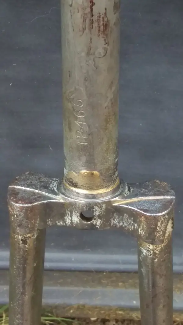

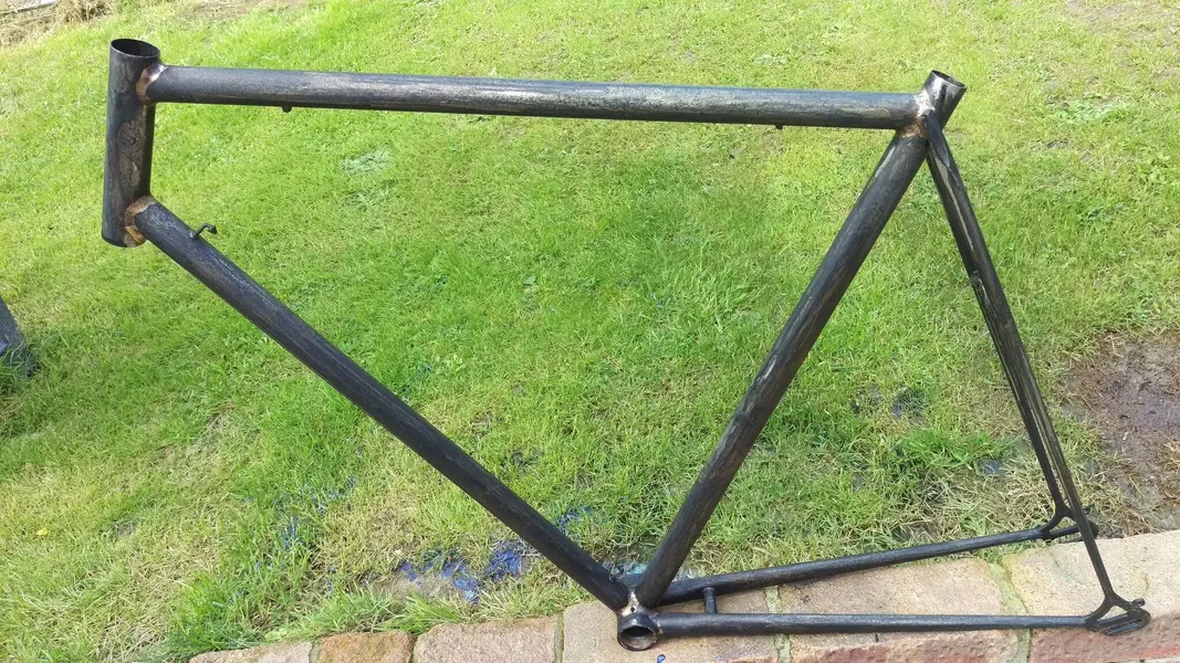

Still working of the last of the rust, the frame is soaking in paper towel with Evapo-rust while I work on other projects.

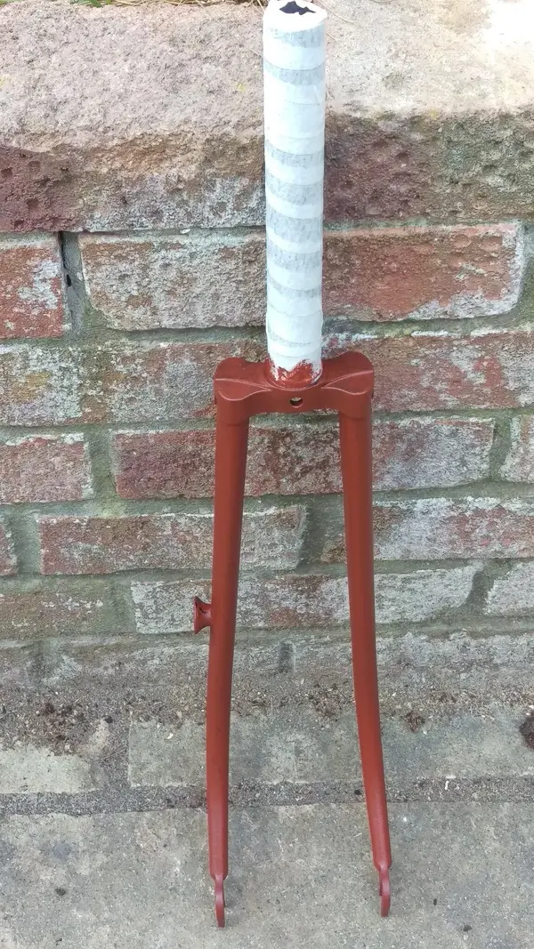

i swear by bilt hamber products. their deox gel is exactly for what you are trying to achieve. i used it on my project two kona forks which were were in a worse state than your frame. once i got rid of the rust the pitting was addressed with high build primer. turned out great and still looking good 2 years later. pics start about halfway down page 4 here ....

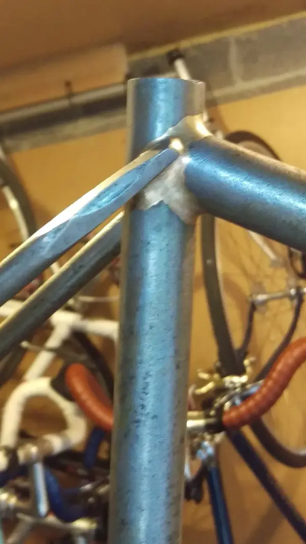

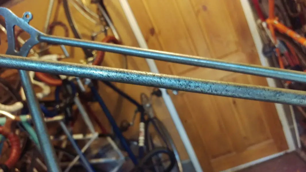

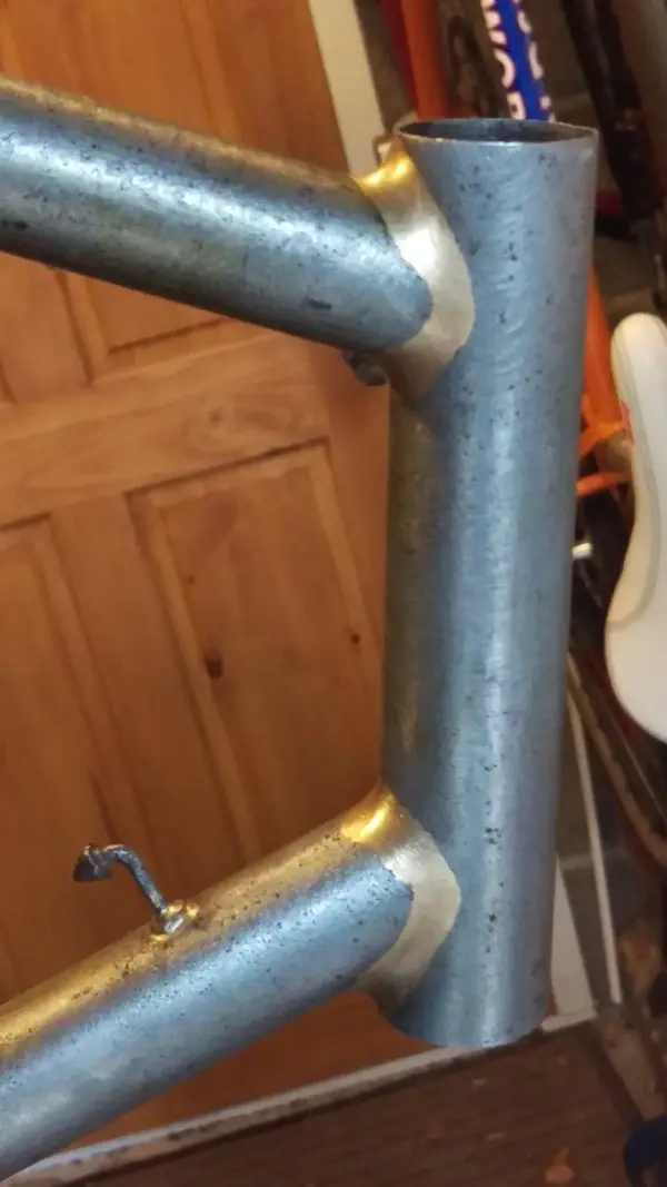

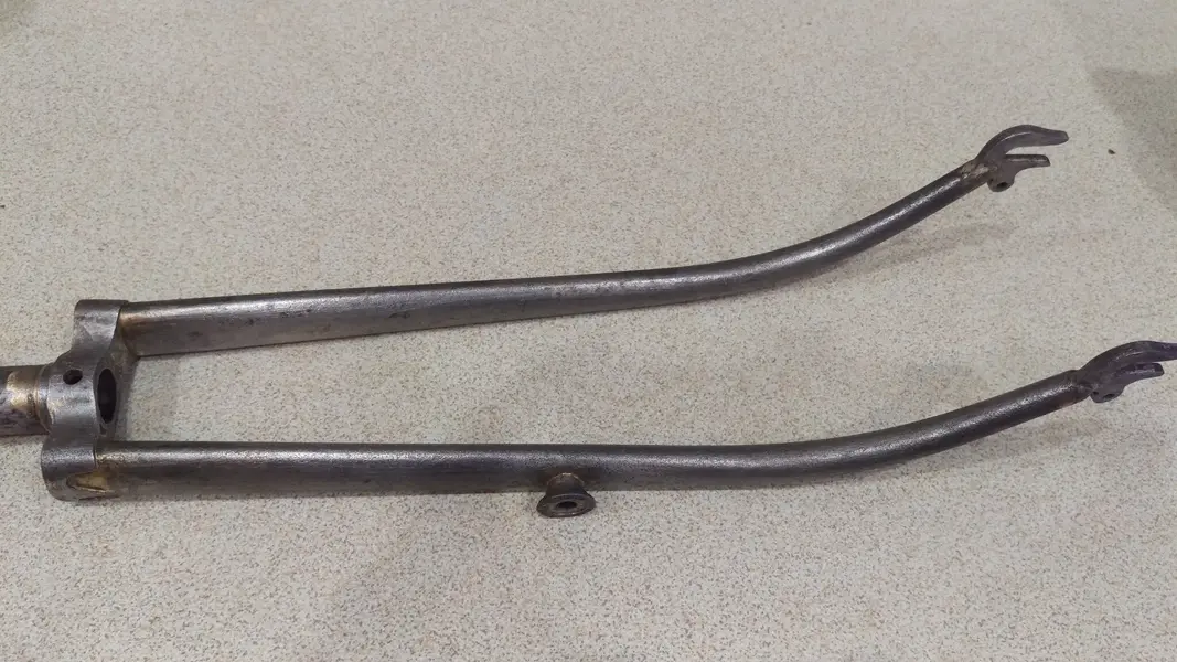

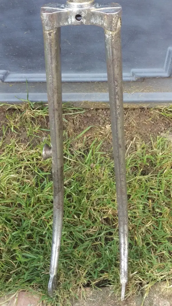

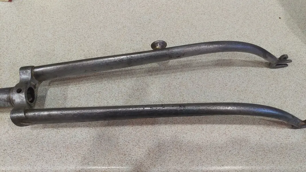

Interesting, i'll bear that in mind. I am getting somewhere with the forks now. Given them another brush with Evaporust and now back wrapped up in soaked paper towels. Think Ill do the same with frame next. IMAG7842.jpgIMAG7843.jpgIMAG7844.jpg
