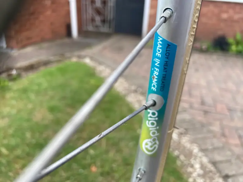

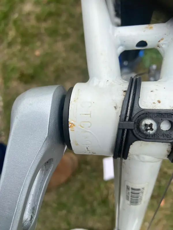

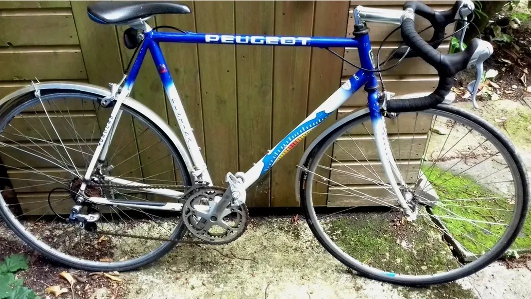

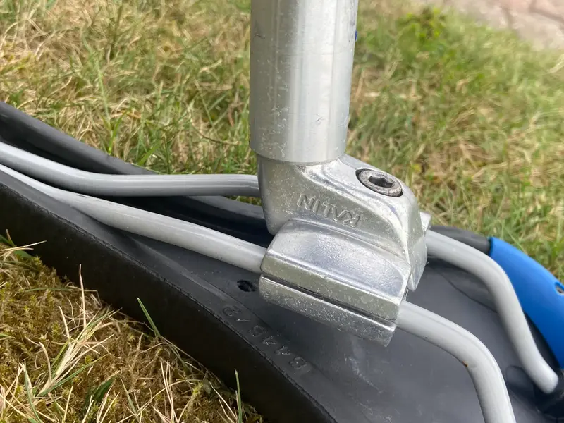

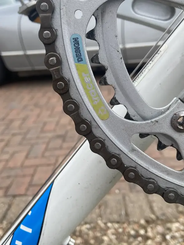

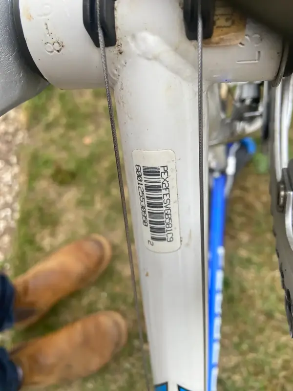

Hello and welcome!

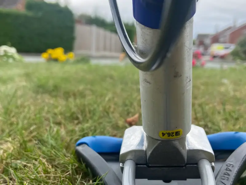

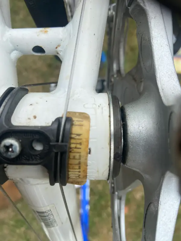

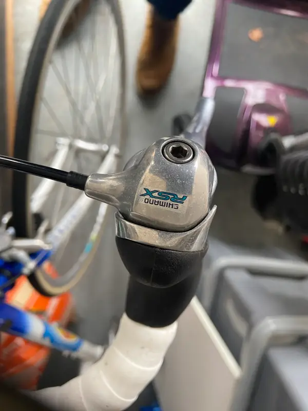

I can't really tell much from the pictures but I'd say that it's probably a 90's bike from the RSX brifters and Tig welding. The 26.4 seat post points to plain gauge tubing but the chromoly sticker means it's not stove pipe tubing which is good. I will say it looks like someone at some point changed out the bottom bracket because there's a spacer behind the fixed cup to push the crank away from the frame. Generally speaking, you wouldn't see that on a factory bottom bracket. So things could have been changed out at some point.
I'd venture to guess it's a middling bike in the lineup and probably a great bike to ride. My first road bike was a Peugot UO-8. That bike was a scary bike to ride and had 27" steel rims and Mafac Racer center pull brakes and the infamous Ava Death Stem that broke while I was riding it. By the late 80's steel road bikes had dropped most of the weirdness and really came into being great riding bikes.
