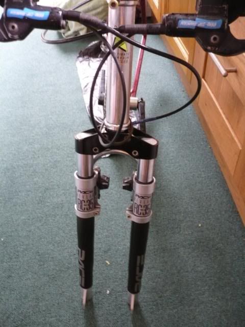

Wheels

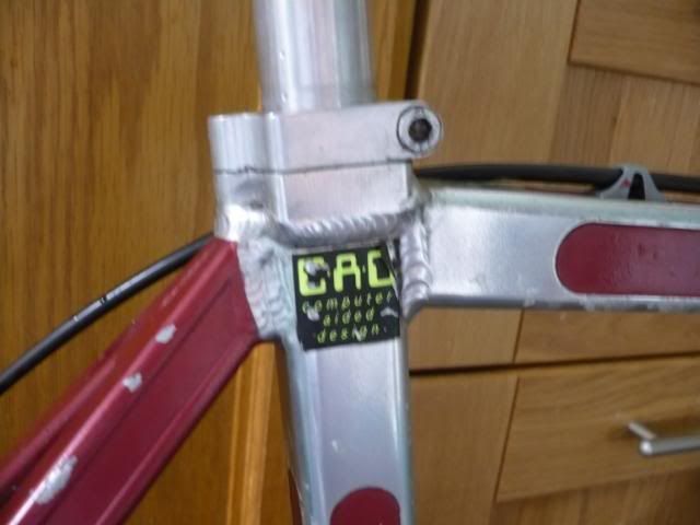

Yes he was saying it had some damage to the top of the seat tube, so he took it back to pace for repair. Looks different, but it seems quite a good job.

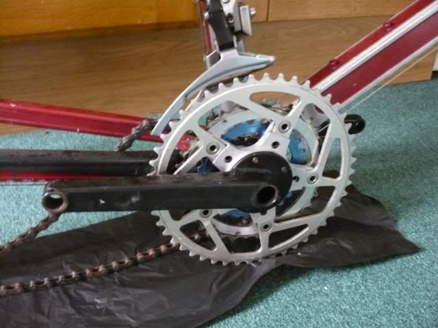

Also apparantly he had issues with the non drive side crank working lose, so had it tac welded to the axel. Im going to investigate having the weld ground back and have a look at what can be done for it.

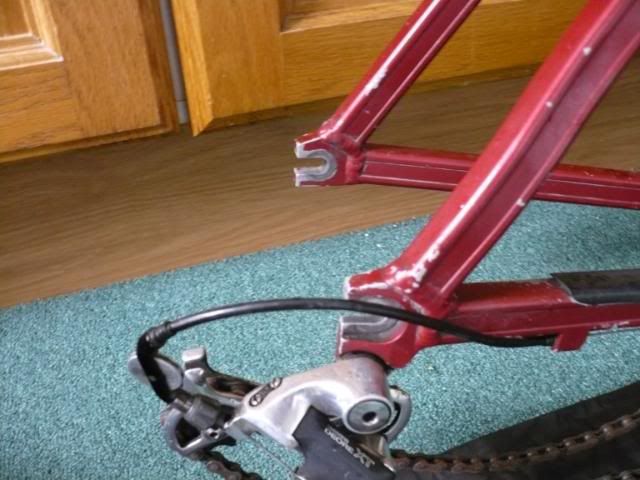

Also what does any one think, strip, polish, new decals & lacquer, or strip spray in the grey ford colour then new decals?

If its just tacked on with weld just use a file,get it down to the level of the spindle then short sharp taps with a hammer should break the weld,someone on here was going to make some Ti adapters for these cranks,cant remeber who it was now though.
Up to you with the colour,im venturing away from the grey/yellow combo tbh,want it a bit different.
Decals may prove a problem too :(
