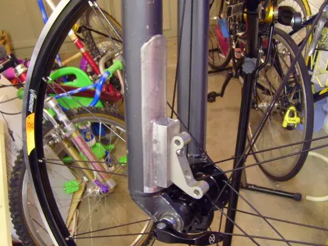

Knocked this up out of some bits I had in the garage.
the plate on the fork leg is 1-1/4" OD 6063-T6 tube cut to suit the fork leg profile, I'm not using this on the one I'm putting on the bike as the 16swg 1-5/8" tube can be manipulated to wrap around the fork leg to distribute the load better.
The disc mount is a stock Marzocchi qr-20 mounted pside down to allow for the reverse offset created by the linkage.
Gives you an idea of what the finished product will look something like.
Its stuck on with bluetack mind you, this wont be used in the final assembly!!!!!!!! :shock:
