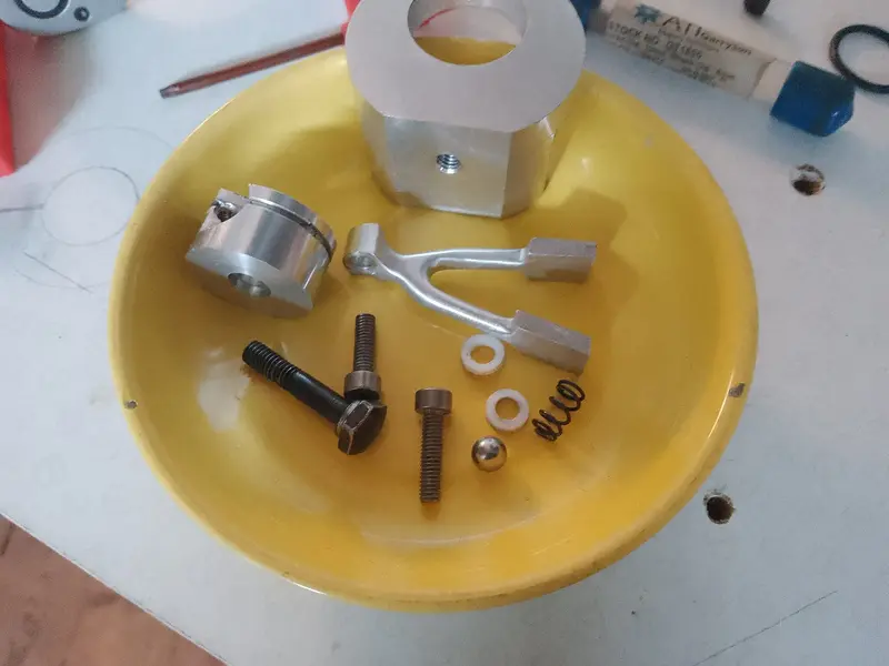

First up make the nylon bushes....they make the body have stiction without friction....I'm sure you understand 😆
So a little platter of nibbles....
So let's have a crack at it! ...cut the socket seat for the ball to land in....
And as if by magic the socket for the sprng and ball to nestle in on the other bit is in exactly the right place...so let's push the nylon bearings in and see how the click feels!
And it feels.......oh so good.. 🤩

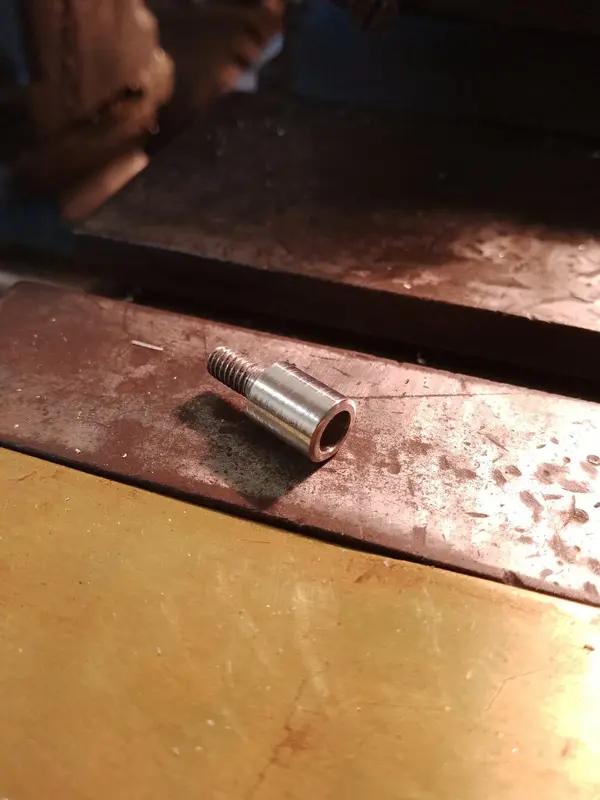

Going to make the main pivot bolt out of aluminium.....if I'm jammy it'll drop its weight below 50 grams......🤩
Plus....I might be able to lose one of the arms!
Remaking the main barrel and increasing the diameter a sniff has resulted in less throw more cable pull so it might not be needed.....if not were definitely sub 50 grams ......get in 👍

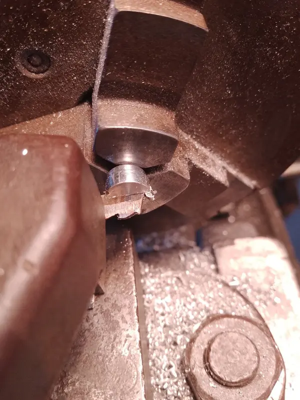

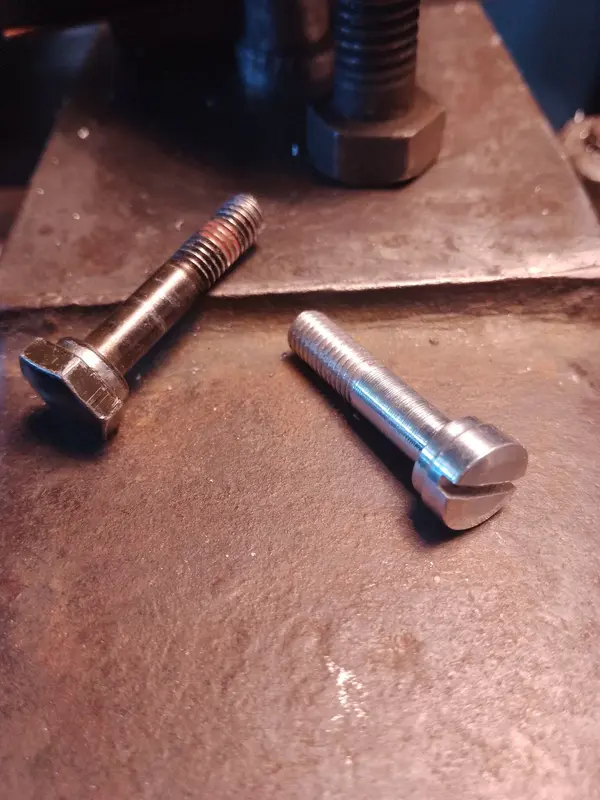

And the new bolt... well a screw ...has nipped off 6 grams of fat...👍
Love having new kit....end up finding new techniques to replace old habits.....always used to cut a slot for a screw head with a hacksaw....not now ! Now I'll just be punching it through 💪

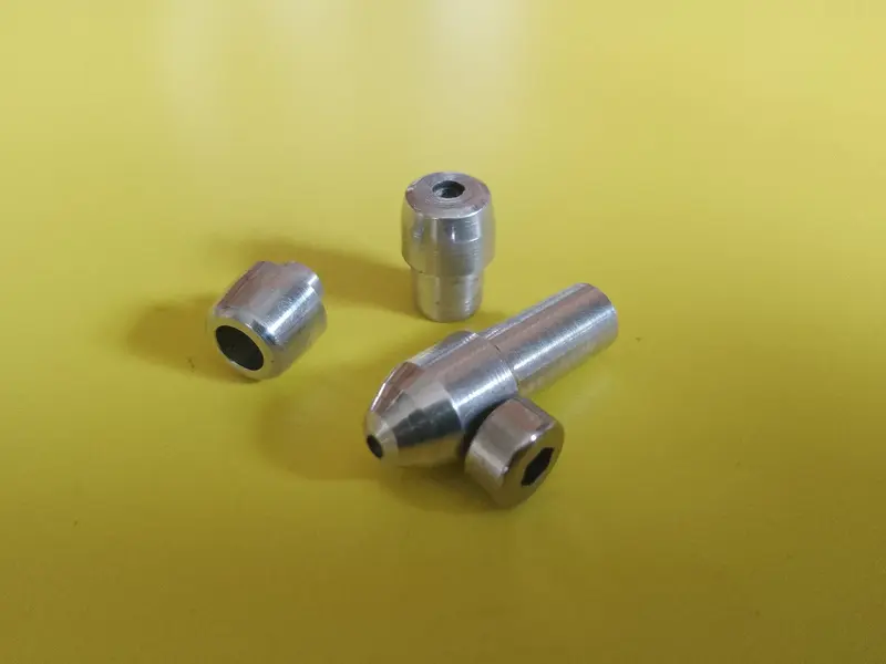

One more little thing to make...😊
A little embellishment and extra laybrinyth seal on the rear axle....and then it's take it all to bits for the final polish...😁

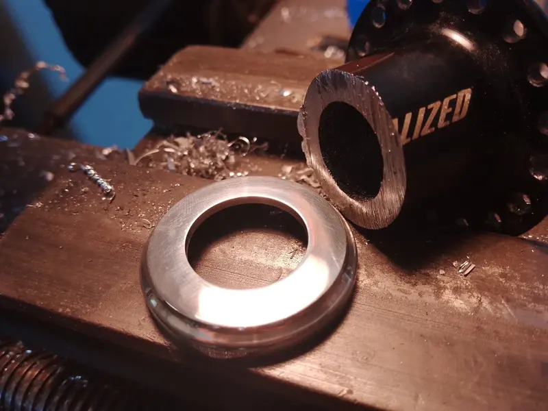

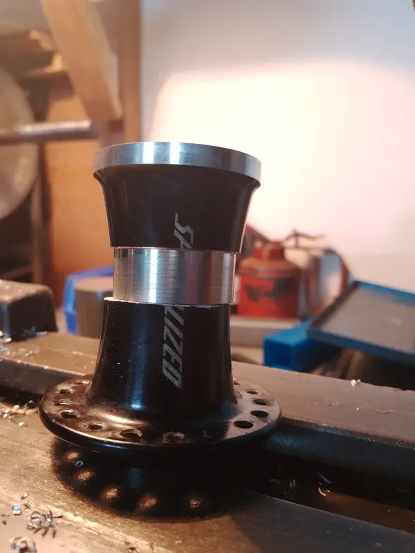

So mister specialized hub.....not so flipping specialized now are you! 😁
A bit of boring and turning and a little shining thing is ready to do its thing....which ain't much other than to look pretty 😊
