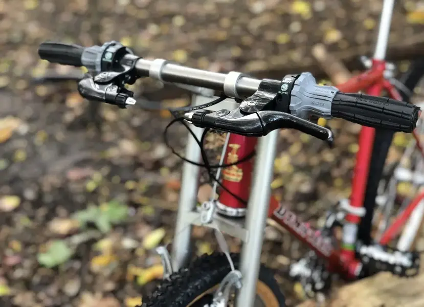

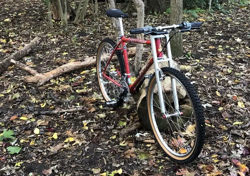

That’s the thing though - I’ve set them up so that’s the action is apparently nice and they are flush with room to spare on the levers - which when completely depressed don’t make any difference - I’m probably doing something wrong - and bit unfair blaming the pads
I’ll take a snap in the morning
Here’s a snap of last time I went out on it
