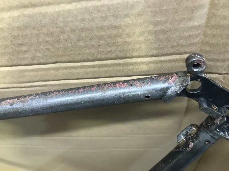

Ok, so eventually it gave up the goods, 99% of the super tough paint has gone, now for a liberal application of elbow grease… Peachy style😉 6FCB9D07-51F8-4665-BD1E-480256094D8E.webp BD4F89C7-89A5-479D-B585-3712D4222D94.webp
Now do I lose the eyelets? (I’m not planning on touring with it & mud washes off)

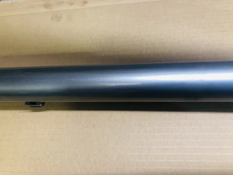

Progress… slow, but progress… D4EBCAA9-0C15-4D06-B213-3177C78E2566.webp 32D9FC55-2092-4007-9CFC-880017143CC1.webp
Cellulose thinners and scotchbrite to remove the acid scum & paint residue, then a wipe over with 3-in1….. the 853 is coming up lovely & it’s tempting to leave as it is maybe with a quick layer of clear coat, but that won’t fly…
Next stage will be zinc plating then I’ll have to decide to stop with a brushed zinc finish, or to polish and get it chromed

🤣 Nope, I just use a local powder coat chap. If the frame had been powder the dip would have cost £10, but because of the layers of baked 2k it took three attempts so he charged me £20.
