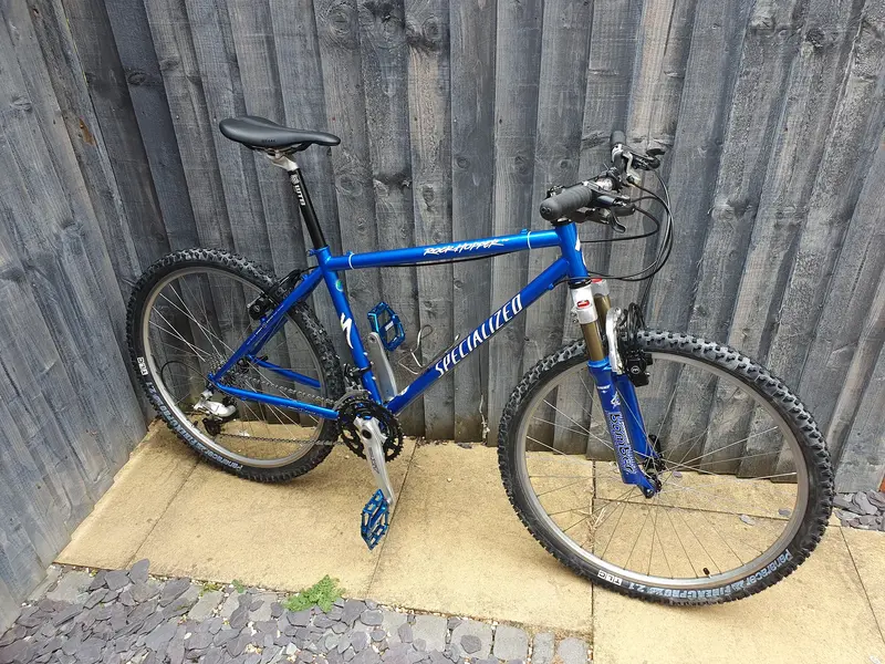

I'm building up a Rockhopper from 1999 for my son. Its Ritchey steel, which can't be bad. A 17 inch, 55cm top tube. Hope its not too big, otherwise I will have to ride it! XT 750 waiting to be added, plus a WTB Silverado saddle, LX hubs and 221 rims. Some blue DMR Vault flat pedals, and brakes will be Magura HS33's, to finish it off.

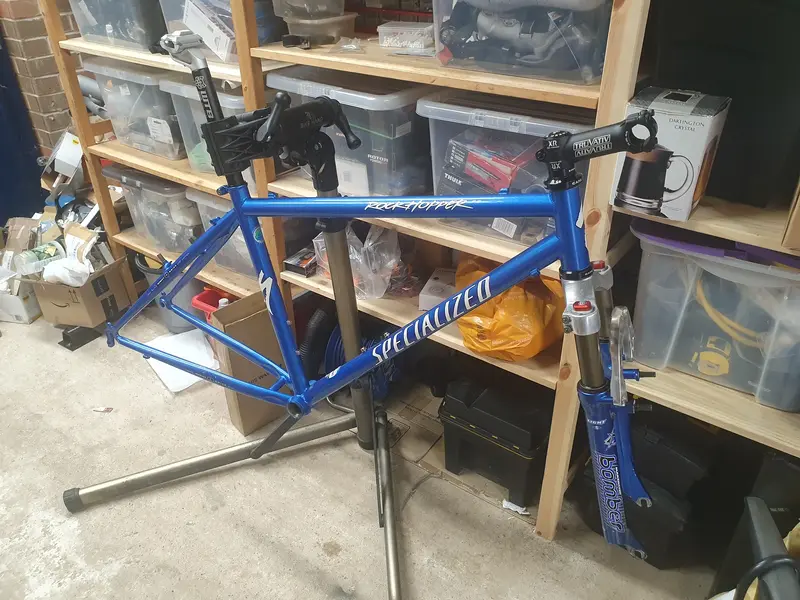

Note the red dials at the top of the Z3's....this is a hybrid Z3 legs with Z2 internals. I am waiting on some Enduro seals. I've mixed Motul Factory oil, 7.5w and 10w, to hit the right viscosity.
I'm wondering what bar to put on it? Any suggestions? I always rated Titec kit, and bought a Titec 12cm cromo stem and Enduro HF bar, but I think the stem is too long for my son, sadly.
