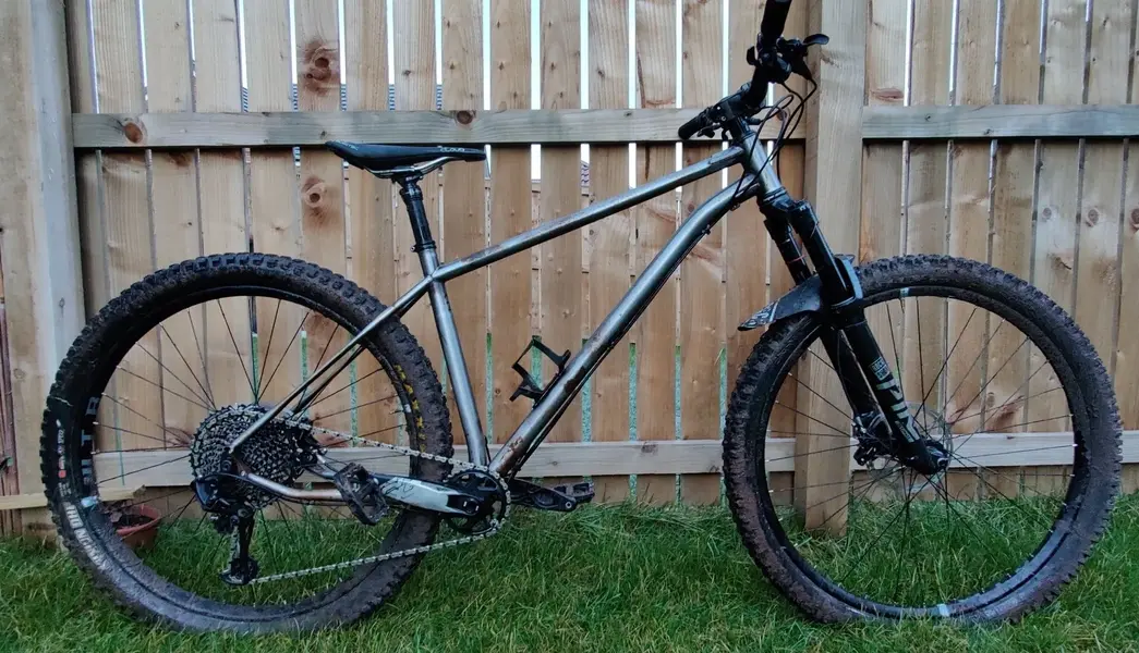

Blimey that is a mighty low bottom bracket - I thought my 'goodness-me-I-need-165-cranks-on-this' Ragley mmmBop was pretty extreme but you must be ground strike city on this. Gorgeous though....
Yeah 80mm BB drop. Pretty wild eh.
Absolute weapon though. Reckon it suits taller riders having such a low BB. Feel like you can stand up properly
That's a very interesting thought. I am 5-7 (170cm) so fit pretty standard small/medium frames and the current geometry suits me very well indeed. But ever since the 90s I have ridden with tall people who just can't get frames which fit in the same way - they are somehow wrong - just adding a few mm or cm to each tube just doesn't do it. A lot of 29ers come out quite tall, and in the bigger sizes that really pushes the riding height way up. This is making me think. Not least, the wattage tables show that tall people need relatively short cranks MORE than short people - counterintuitive, I know, but it's to do with the extent to which they have to move their mass - bigger longer legs benefit more from only describing small revolutions. So...upshot of might be lower BBs with shorter cranks on XXXXL frames....hmmm...I should discuss this with some designers...

Interestingly my bespoke 29er shocked me with the low/short seat tube but is perfectly proportioned for 6’3” 34 leg, as suggested above.
That’s very interesting THM - do you happen to know the BB drop on your frame? And what length cranks do you run?

Was it a struggle with the builder to get the geometry you wanted or was it a natural part of the measuring process which they used?

And they have a contrary view re crank length - they advocate longer cranks for more power...not yet a resolved issue methinks...you can compensate for short cranks by changing gear (I run some 165s and some 170s and it does take a little getting used to, when you move to shorter cranks...) but you can’t lower a BB (well you can a bit, with shorter forks and smaller wheels but that’s not the point...)....
