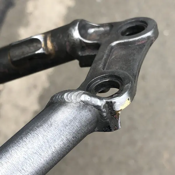

BB chain guide mount went West…

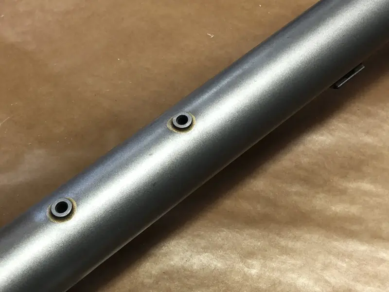

Rack eyes got “Frenched” I nearly brazed up the eyes on the stays but then I remembered if I did I would need to make another set of holes somewhere in the stays because of the nickel process… heating up the stays then drilling them again just seemed a silly risk when these can now be easily hidden under a graphic.

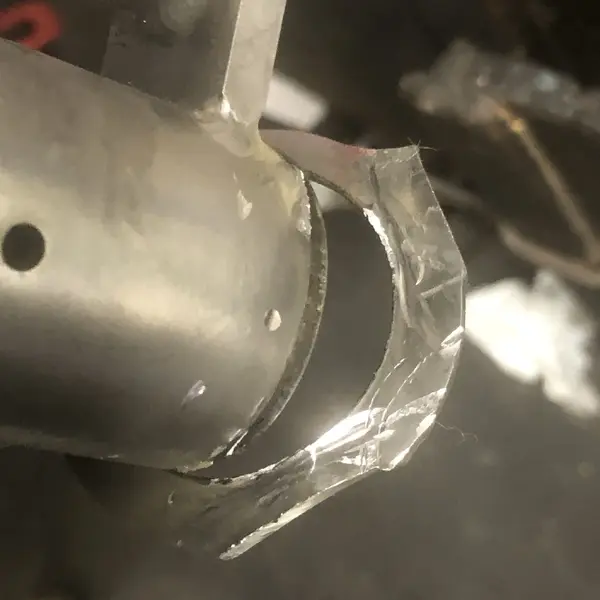

Last job is a light dusting/blasting with fine glass to get an all over satin finish…

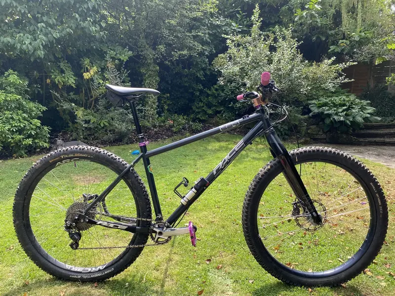

Such versatile frames. Mine has gone fat and rigid for now!

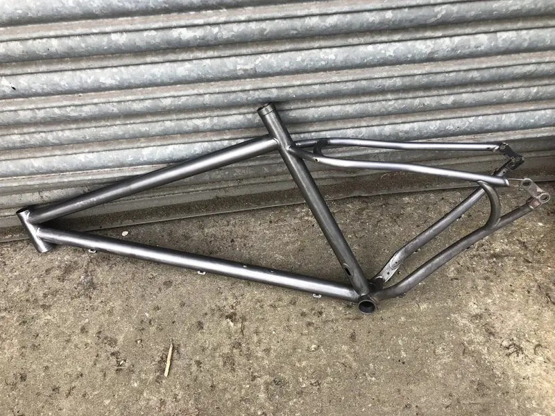

Finally happy with the finish, it’s taken longer than I expected and I’ve gone back over a few bits a number of times but I’ve got to draw the line somewhere. Oh and I’m definitely stopping at nickel, I want that warmer raw steel look rather than a mirror finished chrome. Anyway it’s been handed over to Dave at Allen Chrome (Pocklington, East Yorkshire) for the nickel plating so it’s out of my hands now… 13D3C812-27AA-4B71-8350-818648C222A0.jpeg 5BD912DD-3589-4945-AEB9-CE4E54BE626B.jpeg
