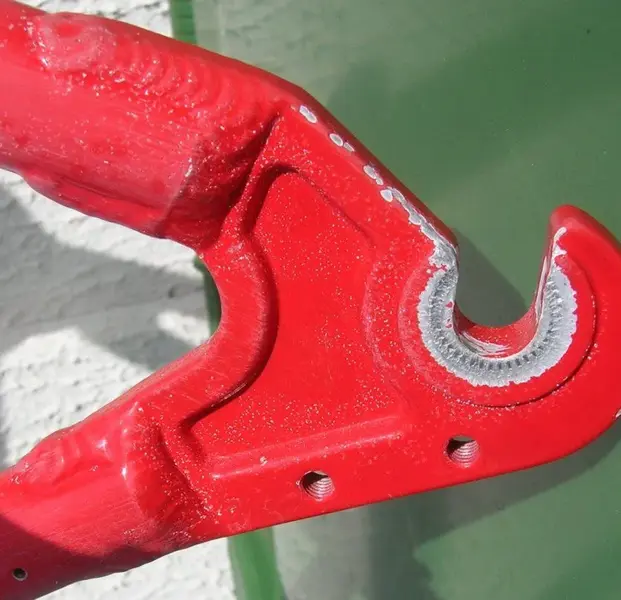

I’ve taken a picture that manages to shows the effect of the Nitromors. It has kind of pitted the surface through to the undercoat – you can see on the stays where I have slightly rubbed the frame over with a view to disrupting the surface.
The Nitromors was on that Dropout for about 45 minutes.

personally, i'd get a paddle sander on a drill and give the frame a quick kicking first to really tear up the laquer & existing paint. alternatively, it may be cheaper (and a lot less hassle) if there is a media blaster anywhere near you that can just blast the old paint off.
Cheers jax13 - I reckon that’s good advice.
The guy who’s doing the powder coating can also sand blast too. He will be painting the frame for beer money. I just wanted to give him less hassle, as he’ll be fitting the job in after work.
I’ve just got back with some coarse Wet & Dry, so hopefully I’ll get most of the paint off.
