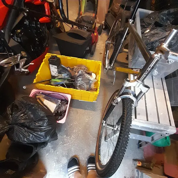

Picked up the pace and a few boxes of parts this morning front his parents. Quite emotional loading it up and driving away.
I have had a rummage and almost everything is there is some forn or another bar little bits like an 8 speed chain and cassette, headset ahead cap, pedals and a front mech.
I've a few boxes of bits I'll look through later. Unfortunately there is a pace stem/steerer, could be one of Dan's but it's too short to fit the frame so the control tech will stay. There is an xtr rapid rise rear mech which I don't want to wish on anyone but I may have another m950.
I'll update with picks over the next few days, the bb however is smooth as haha so that's definitely staying ;)

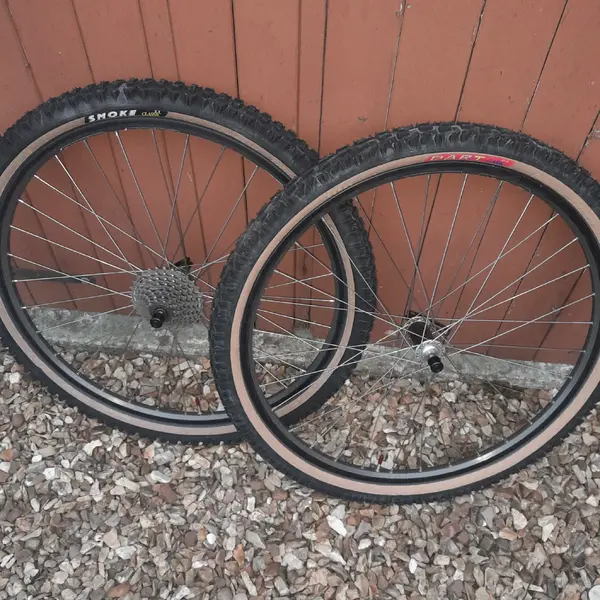

Plan floor tomorrow is to check the headset, fork and trim the steerer, swap the tyred to the smoke and dart and fit an 8 speed cassette ive dug outta the vault haha.

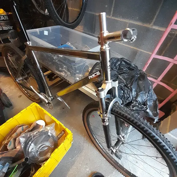

Small update
Tyres swapped and cassette fitted but needs a damn good clean first.
Brifters fitted, silver pace bar fitted and a flite, although mark (dad) wants a comfier one haha, it'll do for the malverns :)
Mechs fitted, found some shimano shims for the front. Rapid rise fitted as it's quite tidy tbf and stevo had kept it.
V brakes dry fitted with the correct bolts.

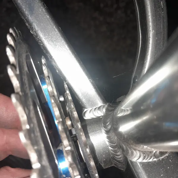

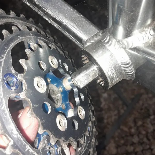

Found an 8 speed chain and tried stevos other middleburn crankset but it's for a longer bb and we're not fuckin around with the bb being rather stuck, although I haven't tried it myself, not opening that can of worms haha

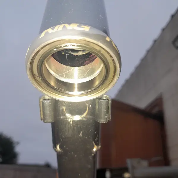

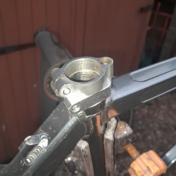

Found a 1inch ahead cap and expander and shortened the steerer to make it look nice. However......... there is no crown race for the Chris king aheadset, looked several times through the parts boxes, these were all they left as they'd had a clear out before steve went back into hospital, I think it may have been misplaced big time so.........
Anyone got a spare 1inch Chris king crown race? Or similar that fitted a cartridge bearing aheadset????
