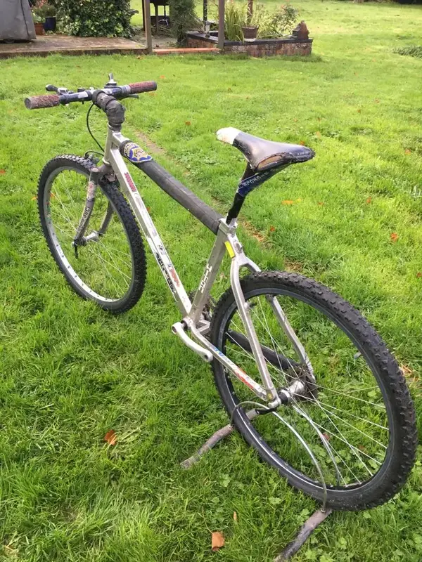

The Bike was mostly used for Couriering/ Messengering in Canada and a little in London, but has seen some off road use and also was used in the Toronto Ice Races!
The theme, if there is one will be 'period correctness'. As anyone who's used a bike for work or maybe for long term travelling will know sometimes when a part breaks you just find the best replacement you can. So there'll be a few mismatched, but compatible parts being thrown in along the way! But since the bike is from '93 (thanks @FluffyChicken ) , trying to keep it around the early 90s where we can.

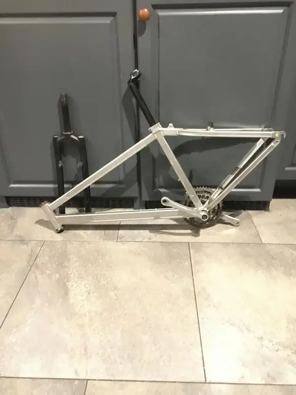

Currently we've got a rolling Chasis. Out of this, frame & fork, headset, bottom bracket, seatpost and stem, wheels and shifters... seem useable
Hoping my Dad still has the Suntour Crankset and XT mechs that were lurking. Magura's are shot and we only have the front caliper. So will be on the look out for some decent Calipers. Bar's were cut down to 47, saddle will no doubt need replacing too!

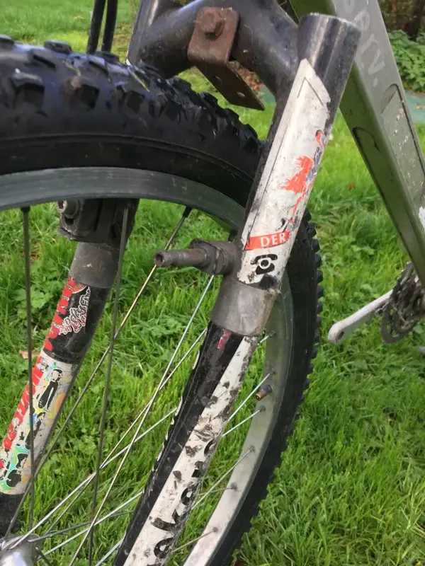

One of the weirder things is the forks. The bike was a prize from a Hamburg shop, the forks are Tange, but that's as much as we know!?

Forks look like Tange Struts, and missing the top caps by the look of it too unfortunately.

I would say - don’t feel like you have to make it perfect straight away. Get it into a serviceable and rideable state, then you can upgrade as you go. You can decide which parts you like/dislike and change them as necessary, while still getting use from the bike.
Depending on the size of the rider, the stem length and bar width may need changing. That’s a pretty hardcore narrow and long courier-style set up on there currently.
