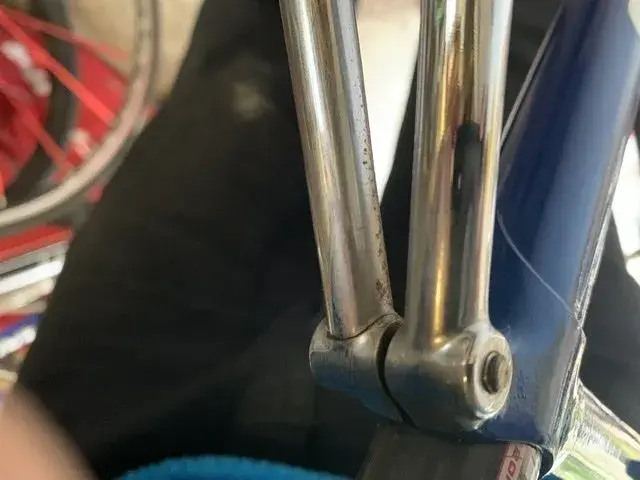

It looks like there is a small crack in the right hand seat stay.
Is this a relatively easy repair for someone with the right skills? Doesn’t look too bad and the frame feels pretty sturdy still.

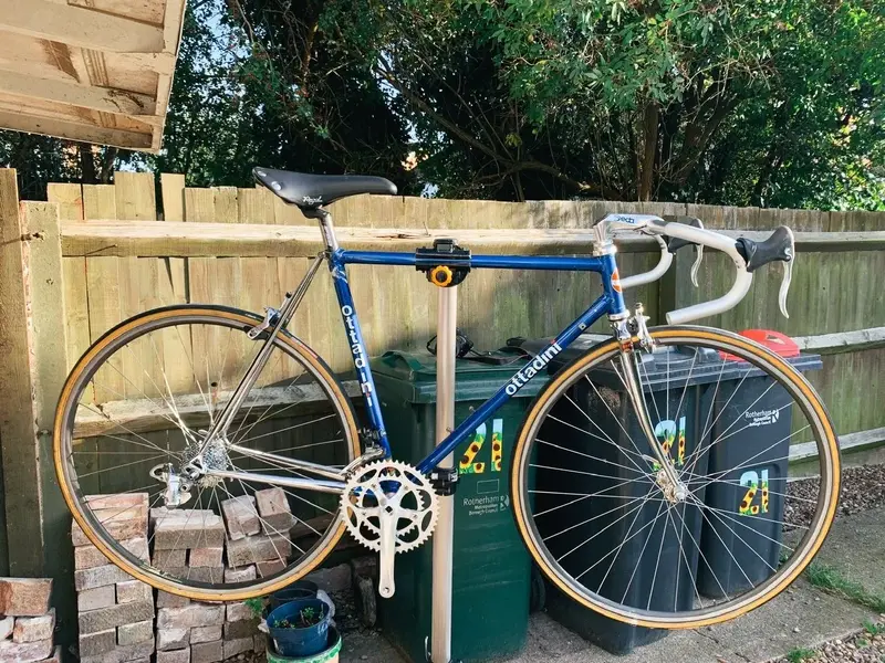

Slight update -
Still waiting to get it painted. If I’m not re-chroming I want to pick a colour scheme I’m happy with. Heading across to Croma Works in sheffield to see what’s possible.
In the picture is a very quick throw together to see what it will look like. I have got Dura Ace frame shifters but my puppy was going a bit crazy so didn’t get chance to throw them on.
I really like the Deda stem as it has a cap rather than being threaded. The levers aren’t age appropriate but they’re decent quality and comfortable. Plus I already had them laying around.
The rear mech is Dura Ace 7400. I do have a matching front mech but the threads seem to be shot on it. The brakes are old 105 callipers. I’ve gone for the regal saddle and will look to get a chrome post at some point. Again, I had it laying around and it saved some cash.
