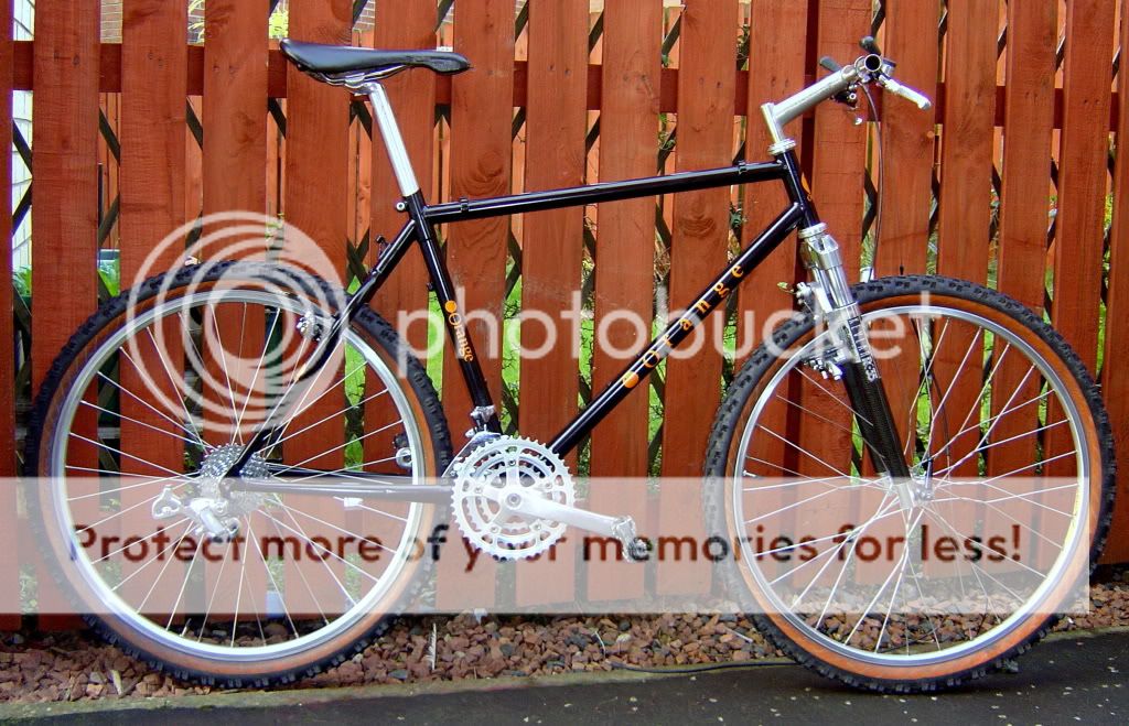

That's a real sad story- sorry to hear that :( your right the steel is thin, however I gave the old girl a real good inspection and treated her to antirust chemicals and waxoyl so hopefully she will see a few more ride's however a dry garage will be the main home for her once built up :roll:

That orange on black look certainly cuts the mustard. More unusual than the standard purple fade and definitely in the timeless classic category.
The only thing that surprises me is that I have never seen an Orange from that era with the seat tube letters on their side like that, they were always vertical, one above the other. Not that I'm qualified to question the hallowed Mr Montague, I could never claim that and I feel sure he must have got this design from some authentic source, but personally I've never seen one like that. Earlier yes, but after 1991 not never ever.
your on the money again, the correct decals for this 93 bike would have the downtube orange lettering vertical however they would have also been in the more computer like font which I don't really like that much (sorry) so I asked gil for the older style ones which I think had the orange side on, you can just about make it out in the 93 catalogue strangely enough in the acrobatic prestige shot with what I can only guess was a 1992 model. The 92 catalogue wont load for me at the mo but I suspect the side lettering is in there. So yeah I have cheated here but a bit of artistic licence is allowed non?

update with more bits hanging on her- what do you think about the tyres- I kind of like them. Cables- black?
Blimey, you've even colour-keyed your fence to the decals, not just your sidewalls!
Yes, black, don't let it get all sweet on you.
Nice one Gazz, does look very well balanced 8)
skewers on the wrong side :P
