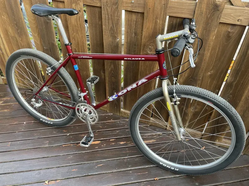

It's gotten some much nicer Titanium Titec/Bontrager bars, I've used a Kona handlebar shim as I think it looks a bit better.

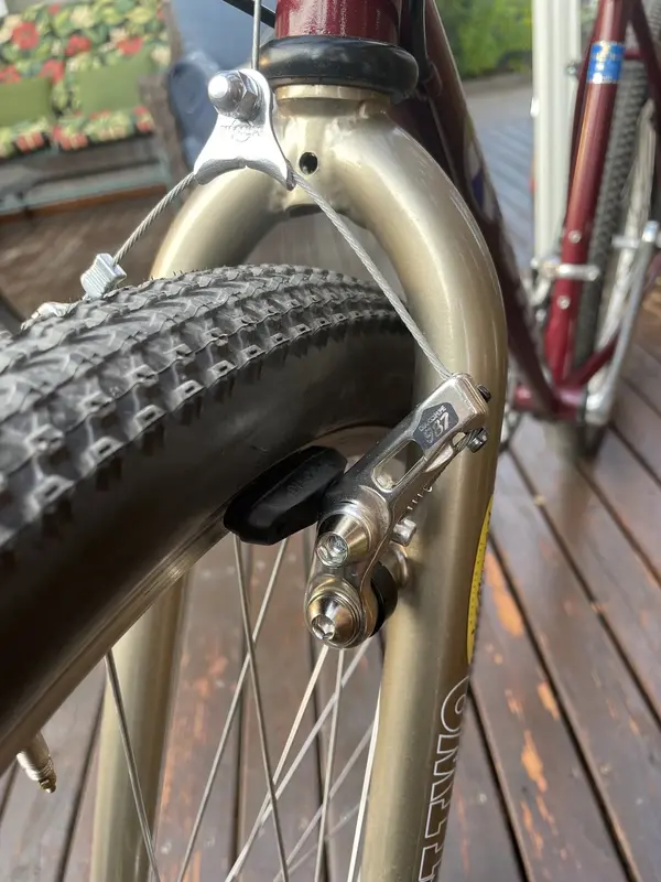

Other new goodies not installed yet: just received NOS Dia-Compe 987s yesterday so will fit them in couple weeks. The 987s currently on the bike work fine but one of the plastic spring covers on the front ones is broken and we can't have that (can we?). My front 987 calipers do not come apart for some reason like the rear version. Unsure why but they are a slightly different variant. Due to this I cannot try fitting an unbroken cover from my stash.
I tried sourcing some used calipers with unbroken spring covers on fleebay with no luck but noticed a full NOS set in box from Germany and couldn't resist.

The NOS 987s are on. I’ve not had the pleasure of installing many NOS parts. These 987s are under rated IMO. My favorite Dia-Compe caliper. So nice to have all original rust free hardware and pads.

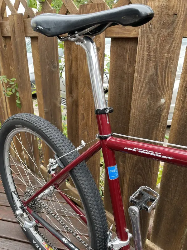

Another recent part change is the seatpost. I found the bike with a 26.8 post and it never clicked until recently it was too small. I did have to over tighten it but still not enough for me to clue in. After reading another Kona build thread recently where it was a 27.0 it dawned on me. The new Ritchey/Kalloy unit has a nice Nitto style head as well and logo mostly in tact. Nice to have the frame pinch bolt not looking over tightened.

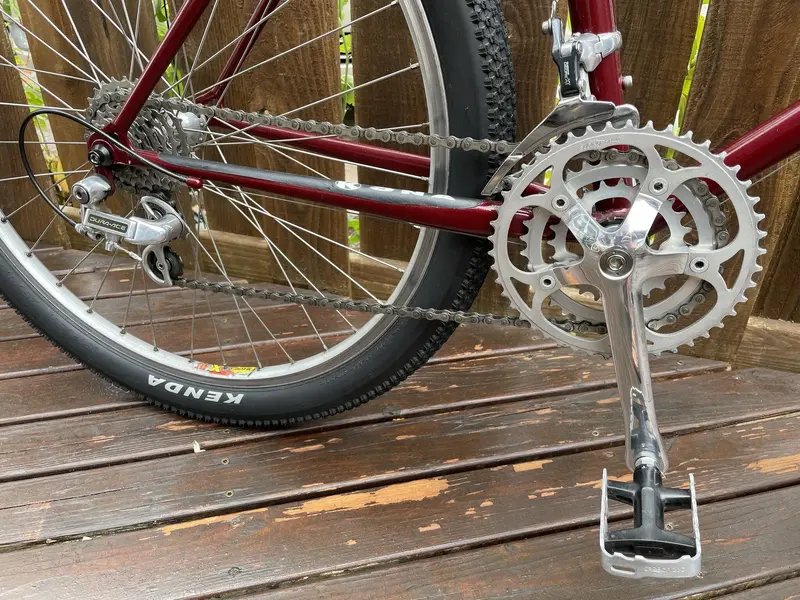

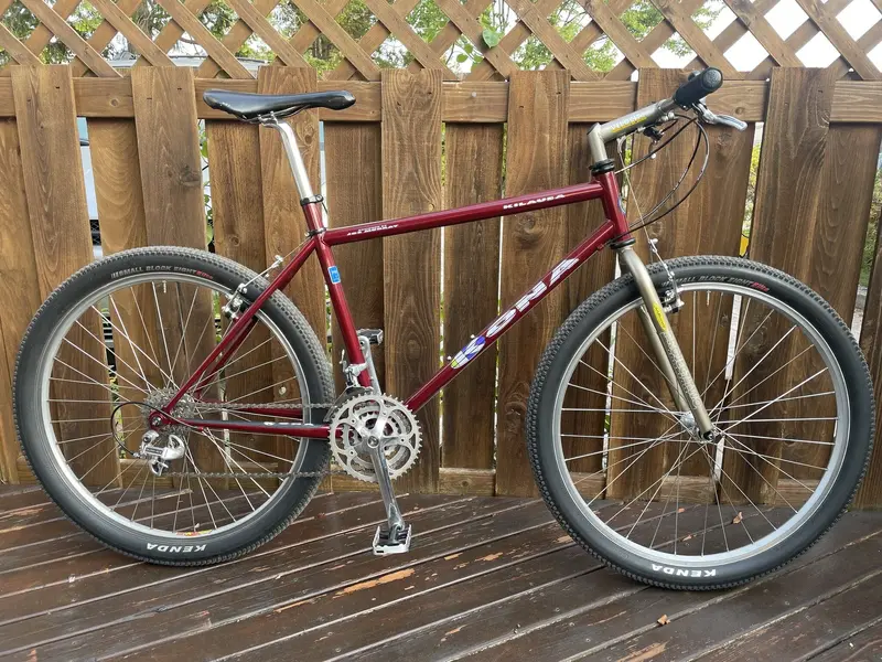

Final weight is 22lbs 4oz.
