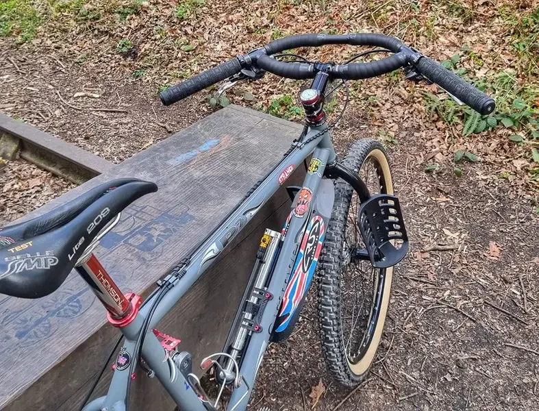

A short physio ride & update to build list. Updated the forks to disc only RC36 EVO3's & giving this high end Selle SMP 209 Lite saddle a go. Bargain - 2nd hand from someone who got the test saddle cheap from a closing down sale. Being so out of condition any saddle would feel bad at the moment so too soon to comment.

I've just started building my '98 Clockwork with Humpert Space Bugel bars. How did you get on with yours? Did you have to change the stem length/rise to suit? I've read you should angle them down a bit, like you have with the Jones bars. I've no experience with this type of bar. Think the Jones look really cool.
Loved them. I ran them just below level. I never measured the angle. I'd fancied a pair of Jones bars & when a fork, bars & stem came up as a deal I went for it. I'm running those at the recommended 15 degrees (They recommend 15-20).
The Space Bugels may end up on my ebike P7 which is going yet another makeover. As it's a commuter I have flat narrow bars on to get through the anti-motorbike gates without stoping but I think comfort will trump practicality.
I ran the Space Bugels on a 120mm 5 degree stem. I built the bike that way so there no change of stem. The Orange Fido stem in an earlier picture on this thread didn't make it to the build. The stem is a 25.4mm clamp so I couldn't use it on the 31.8mm Jones. The stem that came with the bars is 110mm 0 degree & so far so good. I've done about 150 comfortable miles on it over the last few months. The whole geometry of the bike is different though as the a-c of the forks is a good bit more that what was on before but it climbs well although I've still to try it on proper steep stuff. At least with the Loop bars it's easy to get your weight forward. I dabbled with a flared bar gravel bike in the same period & found the Jones way more comfortable.

Thanks for that, just what I needed to hear. Interesting you go with a 120mm stem as I do on my 19" orange hardtails. They normally come with 130's as you know. I left those on for now thinking the back sweep of the bars might cancel out the reach- tbh it looks a bit shite. Really only fitted wheels, tyres, forks, cranks, pedals, seat post and saddle so far to try and gauge the riding position. Think I have a 120 boner fido somewhere. Anyways I ramble on... thanks again for the info

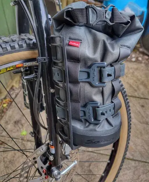

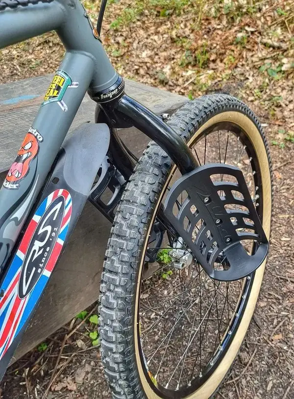

Bit of a change. Now fitted with rigid forks from a Surly Troll & Salsa EXP Anything cages & drybags. Also fitted Jones H-Loop bars & Terra One Rider T1 tyres.
