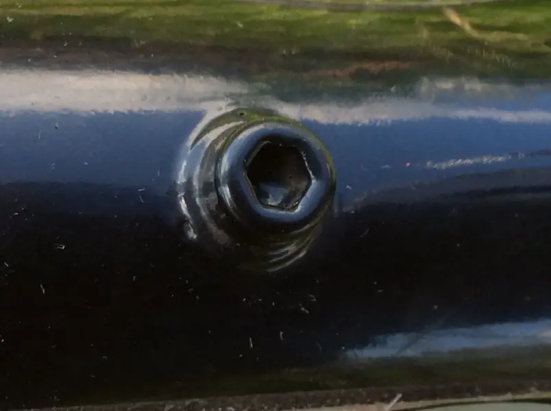

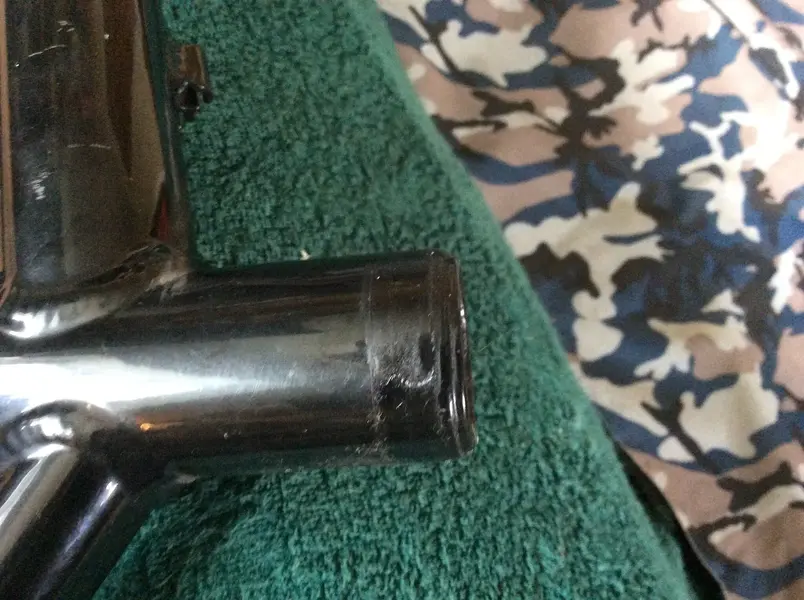

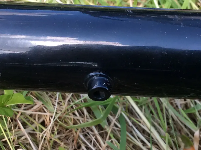

Just wondering though what you all think as it seems to me that it has been resprayed? It's not what I would describe as 'matt', but I've never seen a matt black Orange bike. The Orange stickers are quite obviously 'ontop' of the paint and one saying Series 14 is not aligned centrally. Also, looks to me as if the bolts for the bottle cage etc have been sprayed over? I've tried to include images of those. Will I be able to undo them without damaging the frame finish if I try and mount a bottle cage and crud catcher?

That's certainly not matt black in Orange world, looks like it's been powder coated? Orange supply replacement decals so it could be legit.

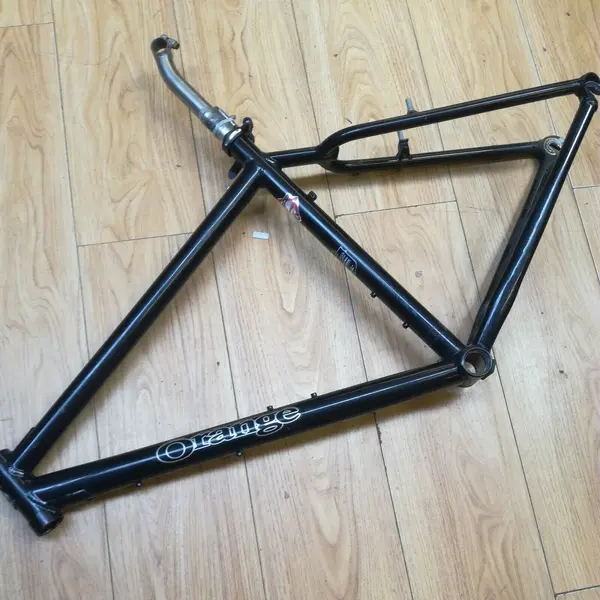

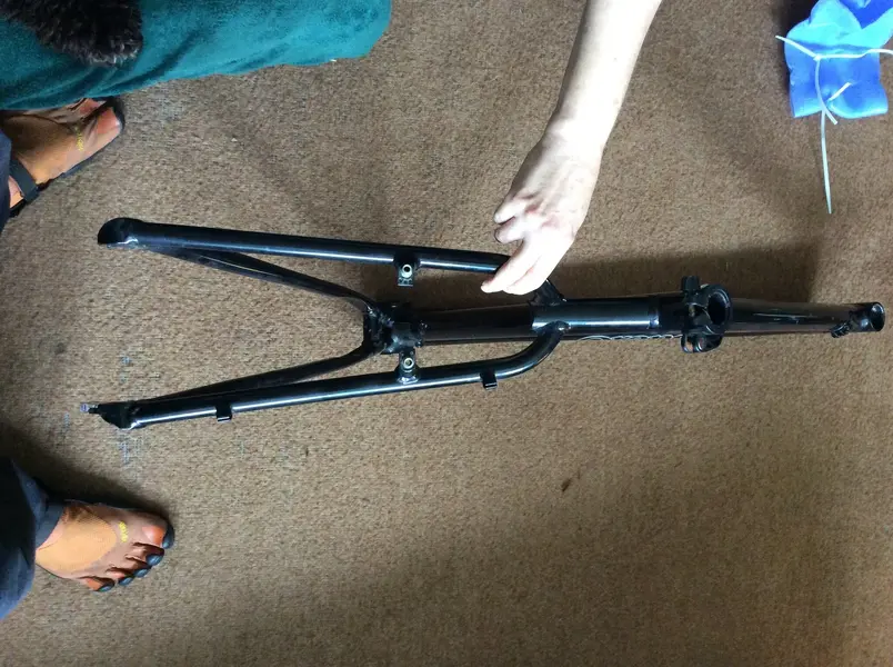

Orange has come back saying the frame number does not come back with anything but they think it's a 1998/99 Orange E4. But a little research says that frame should have an 'S Bend Powerstay Rear', mine looks straight.

The cowl dropouts are very distinctive, and indeed suggests O2 - see 1998 Orange O2 build thread on here...
Indeed that's not Orange Matt Black.

Ah weight - that would be without seat collar, headset cups and brake bosses.
Does the seat collar have an embossed O star on it?

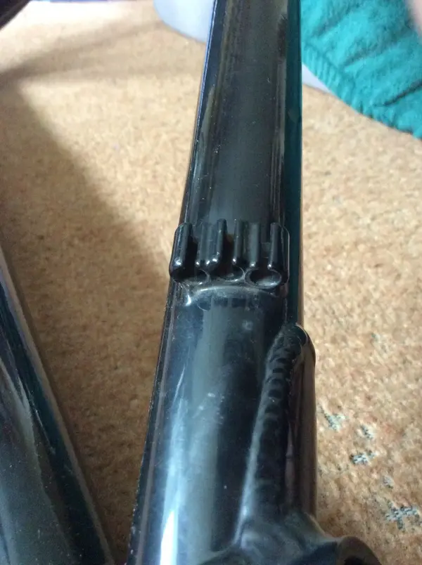

And can you do a shot of the cable guides on the top tube?

The serial number is K6K02830, Orange have said that is unfamiliar to them. They actually thought it may have been an E4 and said frame numbers from the time would have been something like MT80600434. Aparently they have seen loads of fakes before.

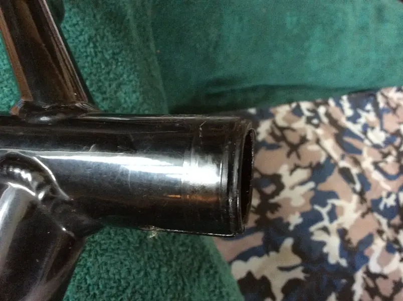

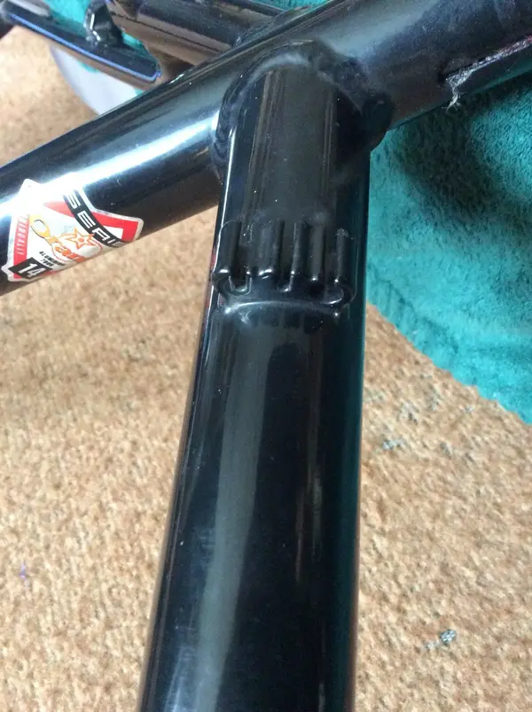

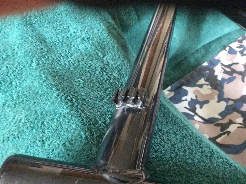

I've attached photo's. The weight was without a seat collar and headset. The seat collar looks to be an aftermarket one.

Thanks Those are very ‘Orangey’ cable guides re both form and position.
That ‘on the tilt’ position is distinctive - most cheap alloy frames are on top or on side.
That gusset under the downtube is very O2.
And another thing...
The seat tube slot is at the front...again very Orangey and not cheap copy-ey
Sorry more.
The O2 came with Supercross riser bars in matt black.
And ... the two Crud Catcher bosses under the down tube. Very Orange. Not very Copy.
