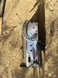

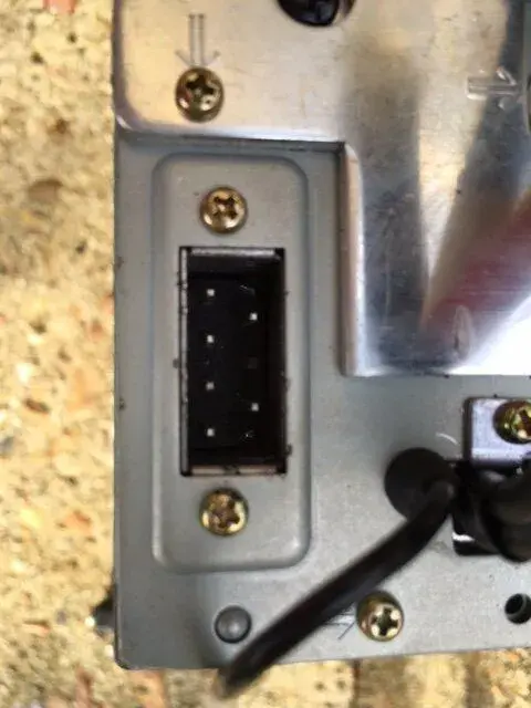

I'll post up a picture of the rear of the unit, showing the separate wiring for speakers and the socket, and another picture of the (power) socket that I need to know the pin designations for. It is a 4 pin over 3 pin layout.
Here's the back of the unit showing the socket in question (definitely 7 pins - 4 over 3), and the wiring for speakers, etc.

And here's a closer view of the (power) socket: (confusingly, the top of the unit appears as the bottom of the picture - thanks, Mac)

Look forward to seeing the pictures!

Anyway, never seen that type before but...
One pin will be permanent, then switched via the ignition, a power out for an electric aerial. There might be a few unused and one will be the negative earth.
It you have a battery charger, that will help. Just prod about and you should be able to sort something out.
