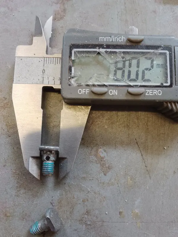

The slow and steady progress of getting rid of little bits n bobs and bolts that just aren't right means .....

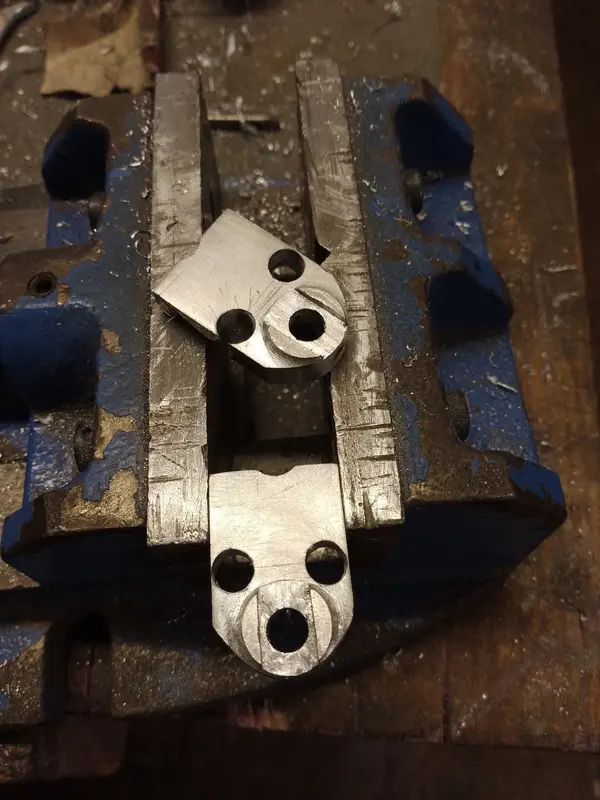

I gotta make some bits 😁
I like making bits !

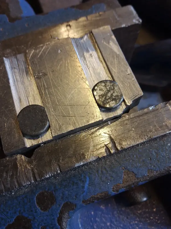

Yup seen em you say...well actually there not what you were thinking....they're smaller therefore lighter 👍 popped a wee hole through and filed some 8mm flats....happy with that .... my crapilers don't lie!! Often 😂
Make some snug slots.....and they fit a treat 👍
Then get rid of most of the slot leaving a nice little raised bump ....lovely...
2 little piggies 🤩
Bit of hacking a bit of filing and some beer swilling later and we have some rather light straddle cable puller uppers....and another huge weight saving!!... oh yes....about 3 grams 😆
Tomorrow I'll do the edge details,thin out the back and then distress them to look a bit more used!
