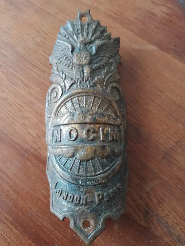

Say hello to my eldest..Nocim! A small known maker circa 1905 to beginning of ww1... That's about all I've ever found other than there might be another in a private collection somewhere in the north of France!
Must refit this!

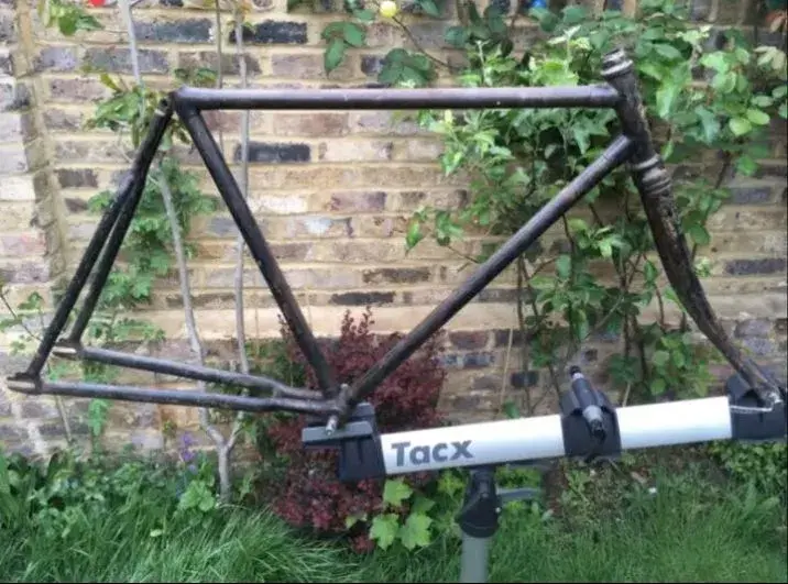

Looks ok don't it?

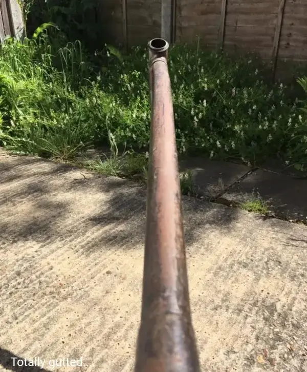

Well somewhere between that pic on eBay and it arriving at my door this had happened...
Mix in a little bit of this.....I was expecting this btw
So challenge accepted!
What a challenge it was getting it straight...
3 big attempts to get it good.twice it checked out fairly good on my huge jig I'd built on my lathe bed but until I'd built it up and tried to ride it...
Clown bike springs to mind!
But I done it...it's possible to ride no hands now so as far I'm concerned that'll do!

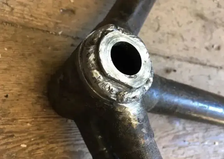

Next job one completely fubard BB shell...the weld hadn't really got hold of that cup but sure had the frame! Shell was out of round ...and threads? Pah who needs threads when sunrace make a push fit cottered BB! So an ugly problem was fixed in a rather ugly fashion.... grinding filing, diamond blocking you name it whatever it took to get it somewhere near something! It's now a 63mm shell
Much fettling with the bottom bracket later and some hefty push fitting it was in....

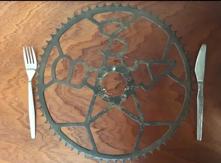

So we're gonna need a bigger ring...
Got lucky with this...
Now although "round" it certainly wasn't flat!
The only way I could figure how to do something about that seemed really dangerous..
So I went ahead and done it anyway
Still here so that's good!
How'd I do it?
Spun it...fast ...real fast and rubbed it back into shape with a bit of smoking oak! The stuff my lathe gets asked to do!
So the little puppy has teeth... 64 in total... Hhmm should be able to find some gear inches with that!

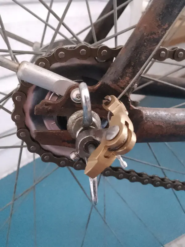

Now the nexus is a petite little thing and steel so didn't seem to stick out like a sore thumb...
But the actuator...
Nope ...can't do that....

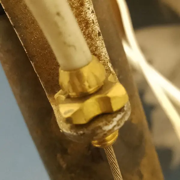

So I made some bits ...cos i like making "stuff"
One fettled by hand brassy classy nexus hacktuator!

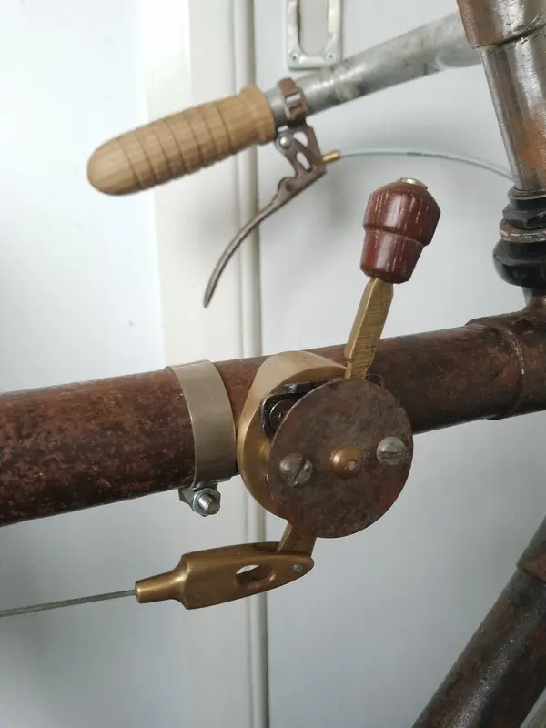

And to make it work I needed a shifter!
I bought a quadrant shifter but it didn't have that feel I was after...that built special one off thing that any self respecting demon of speed should have upon their steed!
Now this bit took an age to file...we have a gated shift...well kinda! Three notches more like and the lever is sprung from the faceplate. So far it hasn't missed a shift or done a rattling ghost shift! Faceplate will be changed ....

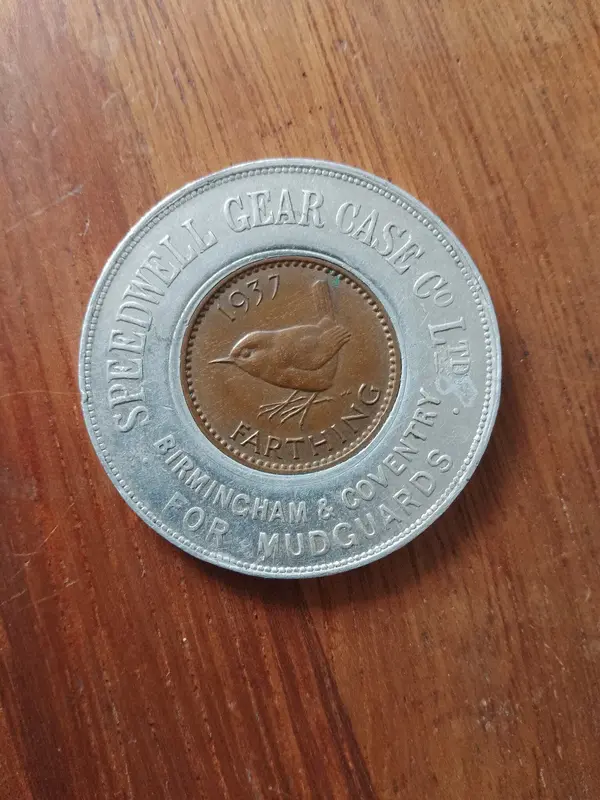

Think this coin will jazz it up nice,don't know which side yet! What do you reckon?
Think this side is quite apt!
Must refit this!
Looks ok don't it?
But the actuator...
